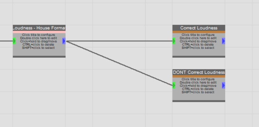

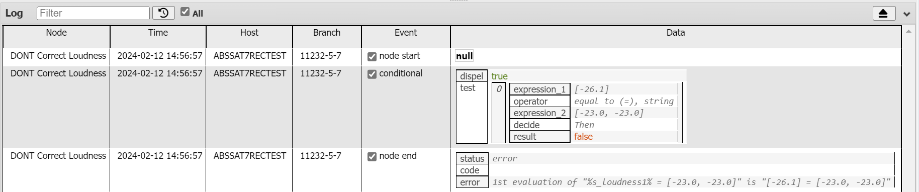

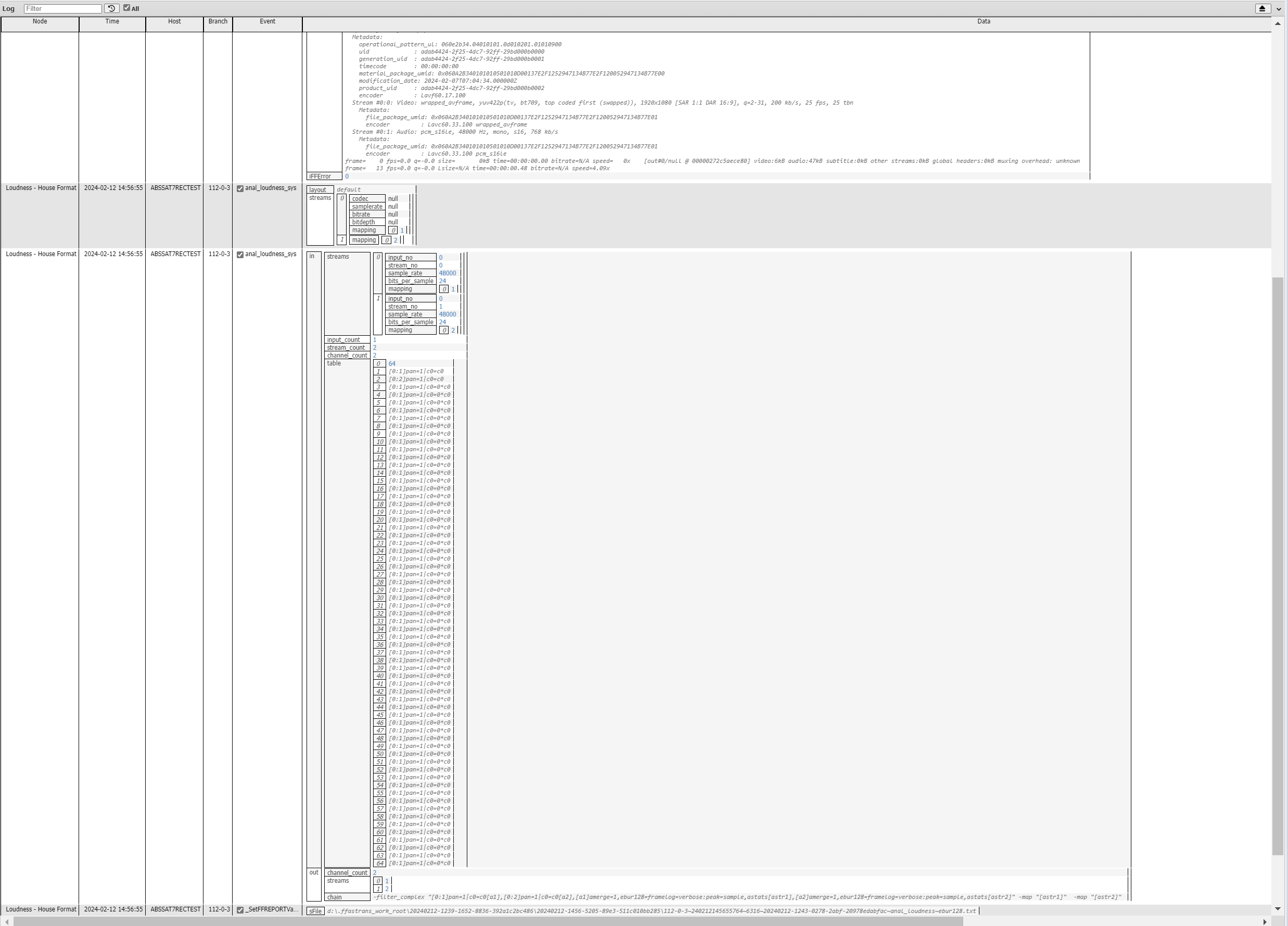

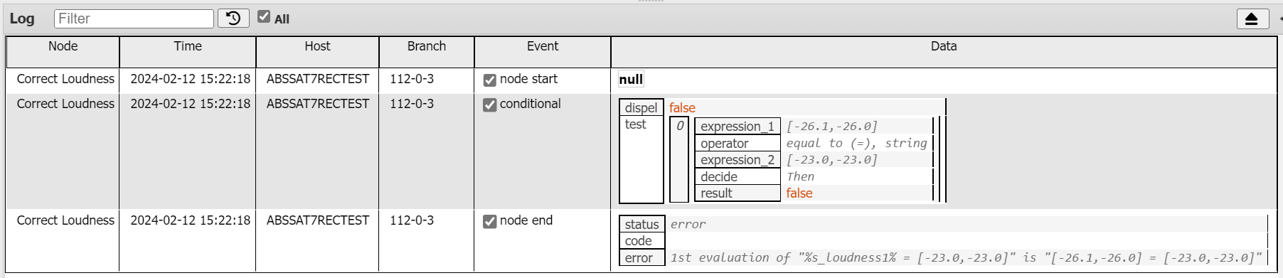

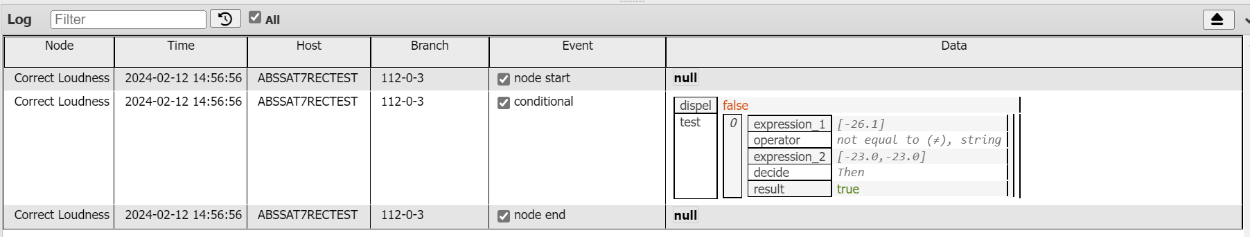

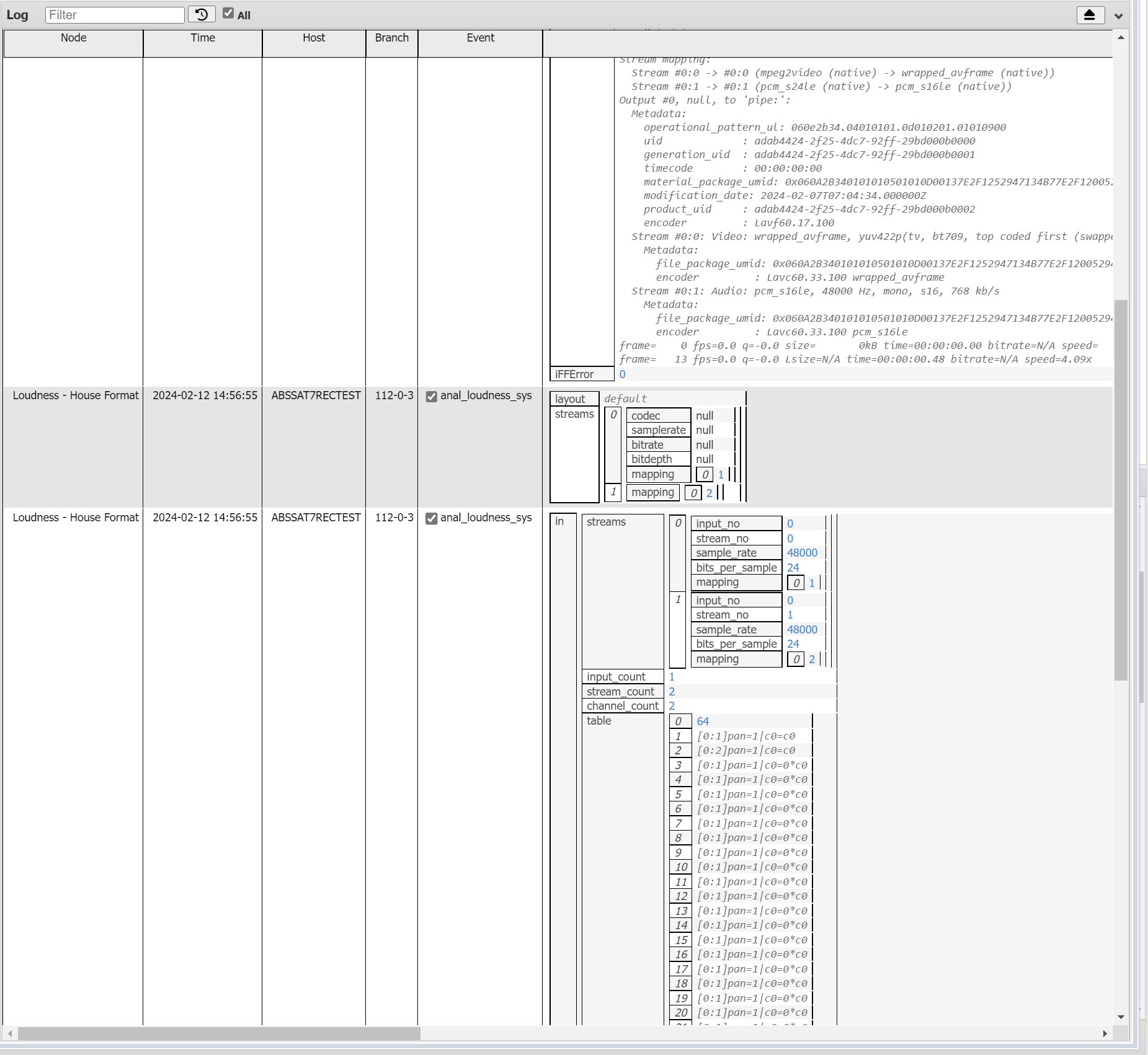

I have been testing the latest version of FFAStrans and have been facing an issue with the Loudness Analyzer. I am analyzing the loudness of dual mono tracks and then determining the loudness level of each individual track. However, it is only returning the level of one track and is unable to read the second track.
Below is the return value of the loudness analyzer on version 1.3.1. This is how it should appear. Below is the return value of the loudness analyzer on version 1.4.0.1. As shown above, the 1.4.0.1 version only returns the loudness level of track one, instead of both tracks. The input file and workflow were exactly the same when tested on both versions.
I also attempted to analyze each track with separate loudness analyzers but it seems that FFAStrans would still return a null value for track 2.
I have attached some screenshots of the logs and a mediainfo of an example source file.
Is anyone familiar with this issue and have any ideas of a fix/workaround?

thanks for the exhaustive error description. I played a little around and also saw that there seems to be something fishy with the whole loudness analyzer trackmapping. Unfortunately i am not yet sure what exactly goes wrong so i cannot yet suggest a workaround. Anyway it is very possible that IF you want to workaround instead of waiting for a fix, you can probably come away with something like extracting the first 2 audio channels to wav
