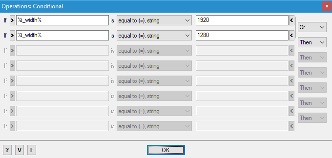

It seems you're using variables completely wrong. You cannot evaluate variables like that. Also, you cannot use media variables in the monitors because there are no media variables populated with data yet. The monitors does not do any media analysing because it's not obvious that all workflows deals with media. Although FFAStrans is media centric it can be used for many different file automation tasks ;-)
To evaluate variables you must add a "Conditional" node after the monitor:
2016-04-19 (1).png (15.78 KiB) Viewed 9996 times
Then you can add the required nodes to process files that pass the conditional test.
Does this help?

Thanks for the insight, this explains a lot. I believe I have what I need to finish my workflows. Your assistance and your application are both greatly appreciated!
