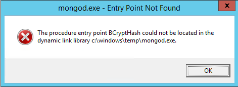

Hi @emcodem
I can confirm that all 4 files listed in your replay are located in C:\Windows\TEMP
I have tried to start DB manually but I have got error message listed in a png file attached.
The dependecies tool has detected one missing DLL: C:\Windows\system32\bcrypt.dll
BR,

Which OS is this, i guess below Server 2016, right?
Yes indeed, it's a WS 2012 R2
BR,
Silicon
Silicon
OK i was under the impression that my current mongod.exe actually supports down to 2012 but i researched now and found out that it does not (bcrypt.dll is part of windows and it depends on several other windows components).
I'll need to check out if i can support a 2 year old mongodb version, it can take a while unfortunately:(
