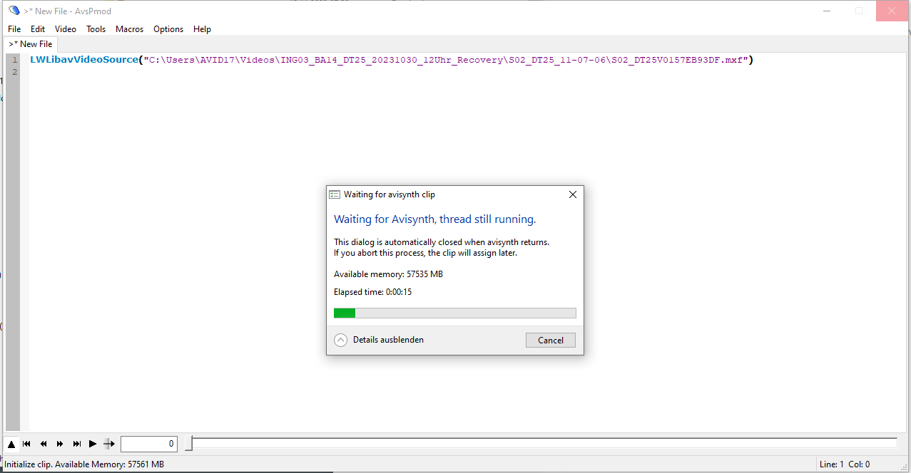

Pippo wrote: Sun Nov 12, 2023 5:59 am LWLibavVideoSource("normal_file.mxf")
Script error: There is no function named 'LWLibavvideoSource'.
Yes that's because either it's not finding the plugin or it can't load it.
Make sure that:
- AviSynthPlus_3.7.3_20230715_vcredist.exe is actually installed and you're not running it portable
- L-SMASH-Works-r1147.0.0.0.7z the x64 dll from the package is actually extracted in the plugins64+ folder of Avisynth (it should be in C:\Program Files (x86)\AviSynth+\plugins64+)
- C++ Redistributable are actually installed on the system https://github.com/abbodi1406/vcredist/ ... 86_x64.exe
Then try again and it should work.
Pippo

Thank you so much for wanting to help me but I don't think it's possible!? It has to work somehow or not? The file has a size and metadata is present. Not all of them are broken, but I hope it still works- look at the screenshots

Pippo wrote: Mon Nov 13, 2023 10:04 am Thank you so much for wanting to help me but I don't think it's possible!?
Oh... so it does take a long time to index and it creates the lwi file but then it fails to actually decode it, that's a shame... :(
