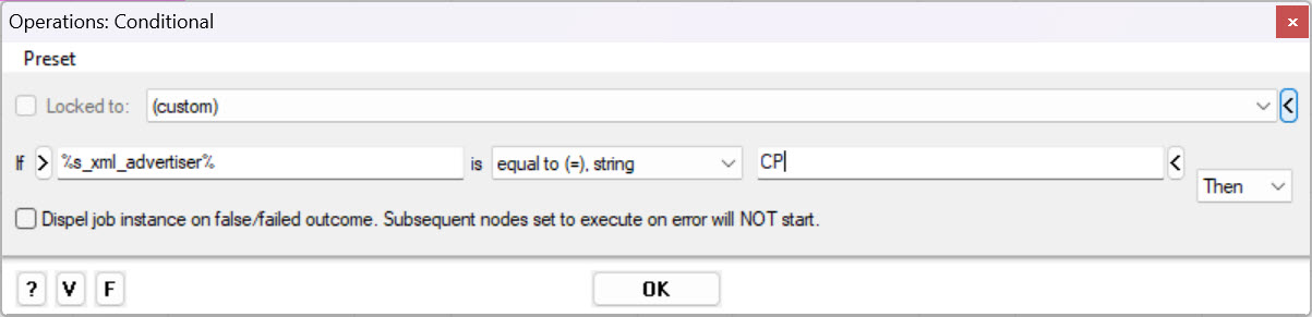

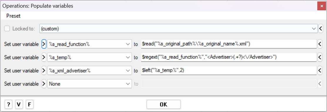

Re: Conditional Node XML Decision
Hi ,
Here is my method, I prefer to use regex to retrieve what you want.
Your variable %s_xml_advertiser% will be "CP" or "CB", just place a conditonal after the previous populate node
So, if "yes" -> CP
If "no" -> CB
Hope it helps.
