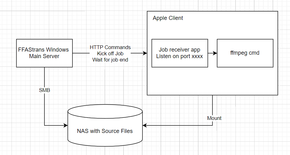

Regarding doing jobs on macos/linux, i have some ideas in my head since a long time. We cannot run ffastrans on these OS'es tough, that will just not happen because of the scripting language that we use and it's tight integration with windows api's.
How i imagine it could work is that you run one ffastrans main installation e.g. on a single windows host which picks up the jobs e.g. from watchfolder, then does all the analyzing and logic to construct an ffmpeg command which should be finally executed on a linux/macos host.
The linux host would just need to run a little application that is able to receive and execute the ffmpeg commands and report back the state and logs.
What would you think about such a setup? ...i believe a corresponding micro webserver for linux/macos is pretty simple to implement. It would just need to be started as a daemon.
One small problem is that one needs to align the perspective of the file paths, e.g. if the main ffastrans server picks up a file on :
\\server\share\file.mxf
The Linux client would need to access it via
/mnt/server/share/file.mxf
The ffastrans job would of course need to translate the unc paths to mount paths before submitting the job to the linux client.

Looks like a good setup for a remote render setup.
and on macos it would be Volumes/server/share/file.mxf
I'm guessing the easiest would be some user config on the apple / linux client to config the first part of the file path turning X:\ into Volumes/server/
Server config (FFAStrans)
Watchfolder name | watchfolder location
watchfolder_01 | X:\my_videos
watchfolder_02 | \\10.0.0.25\my_other_videos
client Config (Mac os client)
watchfolder_01 | Volumes/networkshare/my_videos
watchfolder_02 | Volumes/networkshare/my_other_videos
This way the server would only tell the "client" to look into watchfolder_01 to get to the correct location.
Or watchfolder_01\MyProject\Day4\Card1\ if you want to do a job in a specific folder.
My programming skills are weak, but I'm guessing there is no way to do it automagically.
Re: Camera footage with multi track audio
well i't probably avoid configs on the clients because i usually prefer configuration from a central location. In such setups i normally keep the client software as dumb as possible, e.g. all they need to do is executing the ffmpeg command, no "business logic" at all.
Anyway, before we go down that route, i'd like to make sure you understand the implications. macos/android/amazon (all of it is linux) clients could only execute pure ffmpeg commands that also means most of ffastrans filters (based on avisynth) cannot be used. Introducing avisynth to this kind of setup is unthinkable because most of the filter plugins don't exist for other OS'es than windows. Moreover we have to consider the CPU architecture, it is only ffmpeg that is available for virtually all cpu architectures.
Anyway, such a setup is also kind of "hard to use", so one needs to get a real good benefit from using it.
The reason you mentioned, that you only get like 5 fps using nvidia encoding are not sufficient because nvidia will usually work with minimum 120 fps for a single 25fps fullhd proxy encode. So you just have to find out whats the speed break for you and voila, your windows encodes with 5x realtime, 2-3 jobs paralell without using much cpu. As there are still cpu resources, you can additionally encode 1 or 2 with the same speed on CPU and voila, you got 5 jobs at 5 realtime on a single machine.
If you can tell me good reasons that beat all of what i said, you got my attention :D

Pure FFmpeg commands is no problem, as this would probably mostly be used for large scale proxy generation.
I have gotten my workflow to work better for both P4000 and 3080. And I guess with some tweaks I could get it to work on cpu and "software" encoding.
The best reason would be that many if not most production houses / editors have Apple computers as their main editing machines / ingest, and the M1 (and I guess the M2) is pretty decent at encoding h264.
We see more people working from home, often on average laptops, and a quick proxy encoding and upload to the sky helps reduce the wait for footage from the photographer.
Then any Apple based production houses only need to buy a basic windows machine as a server to delegate the work to a relatively cheap iMac or Mac mini.
But for my part, I'm creating my workflow based on nvenc, and I'm happy with that, for now atleast :)
