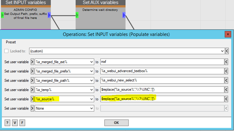

Hi emcodem
I'm testing the same trick i.e. modify s_source variable using the function $replace('%s_source%','\\?\UNC','[') - I have added it into the first Populate variables node of your wf. But foolowing node still works with the original s_source with \\?\UNC.
I'm missing something very stupid, but I don't know what it is :x
modify s_source var.PNG (22.95 KiB) Viewed 10594 times

Re: Concatenate
Hey @Silicon,
check out my updated workflow, it is using a new variable instead of s_source.
When you do
%s_source% = $replace('%s_source%','\\?\UNC','[')
Then ffastrans will immediately redo the changes internally.
Instead you need to drop the usage of s_source throughout the whole workflow and replace it by some user variable e.g.
%s_sanitized_source% = $replace('%s_source%','\\?\UNC','[')
From this moment, s_sanitized_source contains the interesting data and s_source should not be used anymore.
I wrote this in the post where i suggest the replace:
in another variable than s_source because ffastrans would immediately redo the change.
Sometimes the stuff that i write contains vital information without highlighting it, sorry for that.

emcodem wrote: Mon Nov 14, 2022 8:06 am When you do
That's exactly the workarround I've applied - use a new variable instead of s_source. So in fact it is not a workarroud but a proper way ... OK :roll:
I've missed this cruccial info that one have to use another variable than s_source because ffastrans would immediately redo the change :(
Thanks a lot indeed

Re: Concatenate
@Silicon s_source can be altered to your desire at any point in the workflow. In this case, we just found out in ffastrans Version <= 1.3:
If the value is longer than 256 characters and these chars contain \\ or X:, ffastrans will replace the first character to \\?\UNC
That should be the exact description of what happens internally to s_source in our case here.
