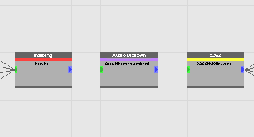

In the meantime, if you want to go through Avisynth, here's a workflow with a custom avisynth script that does the job
AudioMixdown.json
(26.73 KiB) Downloaded 706 times
this way you'll still be able to use the built-in encoder, but of course you'll pay the "penalty" of indexing as you have to go through the A/V Decoder.
Screenshot from 2022-10-17 11-42-54.png (2.28 KiB) Viewed 7676 times
( and just between you and me, I always index every source I get 'cause I always go through Avisynth, so I consider it more than acceptable :P )
( p.s you can ignore all other nodes and just take the Indexing + AudioMixdown nodes )
