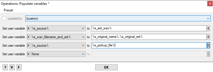

Since FFAStrans 1.0 or such, we have the regext function which would make your function combination a lot shorter:Vladimir wrote: Wed Oct 20, 2021 2:59 pm is my way to get "Filename.Ext" from "LongLongPath\Filename.ext"? contained in the variable %s_ext_wav%.
Looks strange, but it works.
$regext("%s_ext_wav%","[^\\]*$")By just setting s_source to your calculated filename, you can access all the juicy inbuilt variables like %s_original_name% and such.
All you have to do at the end is to re-set s_source to the actual source file you want to work with, e.g. %s_pickup_file% is the filename that was originally submitted - in order to make the next processor working with the originally submitted file instead of %s_wav_ext%

Sorry, but "change_s_source_temporalily" method can't work. The s_source variable is very stubborn.
I send:
то the WF in attached "External_Path-Name-Extention.json"
and have the result:
What could be wrong?

Hehe, I don't think the s_source variable is stubborn. It works exactly the way it should.
You're doing this:
%s_original_path%\%s_original_name%.%s_original_ext% -> %s_submitted_file1% -> %s_temp_var_str% -> %s_success%
So the outcome will naturally be your input file: \\synology.local\InWork\PISMA_IZ_PROVINTSII\Kostomuksha\Kostomuksha.mxf because:
%s_original_path% = \\synology.local\InWork\PISMA_IZ_PROVINTSII\Kostomuksha
%s_original_name% = Kostomuksha
%s_original_ext% = mxf
The %s_source% variable can change a lot throughout a job but the %s_original...% will always stay the same; only populated at the very start from the initial %s_source% variable before any nodes are executing.

Re: FFAudioSource: The index does not match the source file
Ah damnit, my bad... i just assumed that the "name" variables change with s_source because the "media property" variables do so.
Really sorry for bringing you on the wrong path here Vladimir
