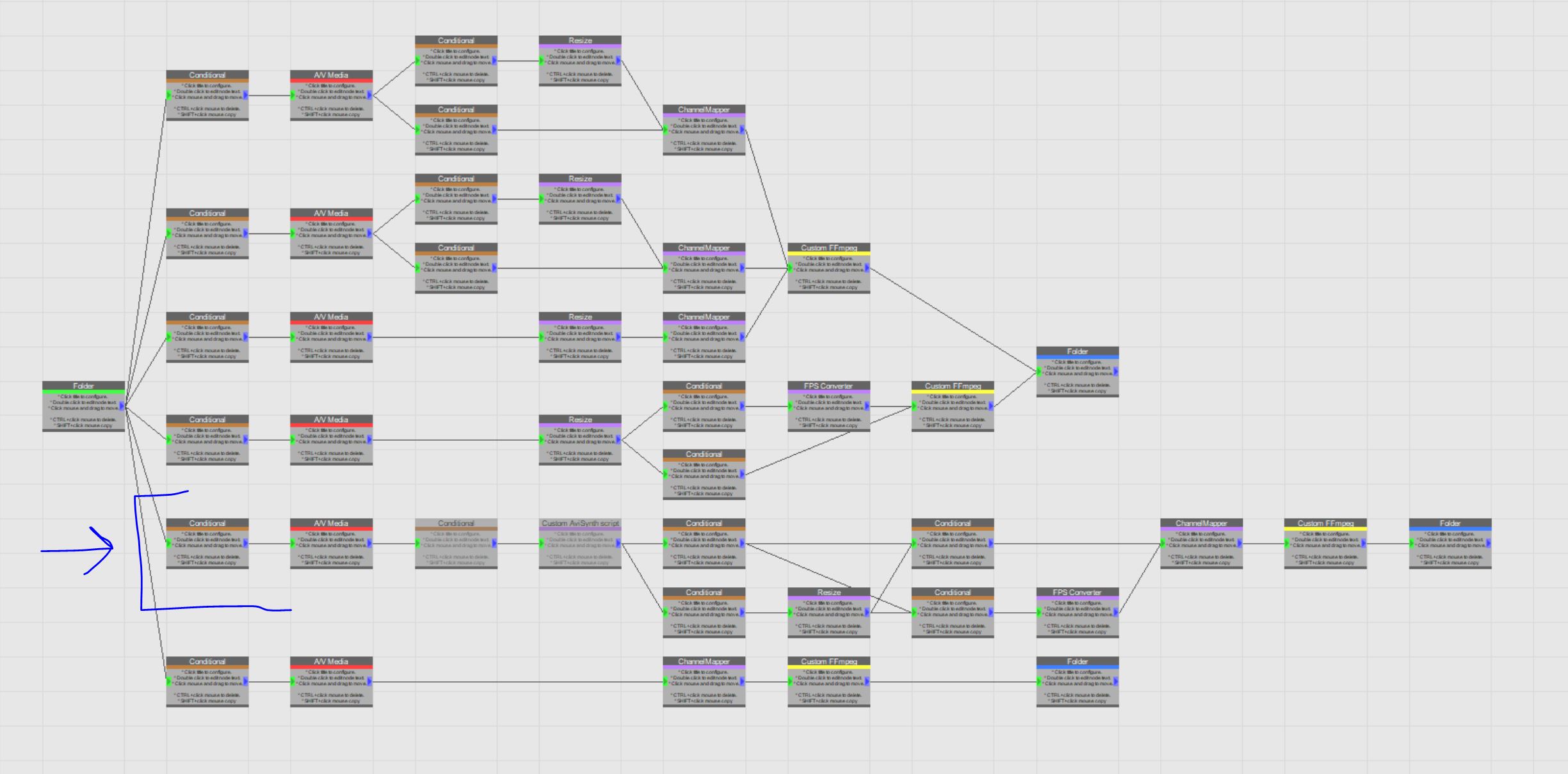

I've attached the workflow which has the rotation part bypassed for now. The image shows which line the rotated footage will go down.
I thought that may be the case which is why I tried moving it before all the other nodes, unless its the A/V Decoder which is removing the rotation?
Auto_Proxy.json
(49.87 KiB) Downloaded 834 times
Re: Rotation metadata
Yeah looks like the A/V decoder resets the flag. Interesting situation that @admin might want to look at.
I guess meanwhile you need to store the original rotation flag in a user variable.
