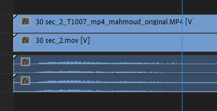

Many thanks for your time and efforts. it's really appreciated.
here is how they look at my end;
closer look.
02_090620 more zoom.PNG (71.29 KiB) Viewed 14341 times

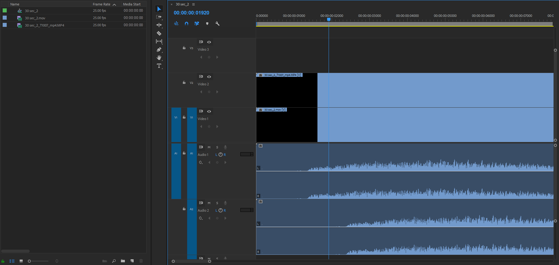

Hey Mahmoud,
Mahmoud Rady wrote: Tue Jun 09, 2020 12:12 pm
No worries, i am used to this kind of debugging and i know when i just don't let go i always come down to the bottom of the problem.
OK, to keep our tests in sync and dont confuse any files, i created a package (i know you already have the files but... you know...):
https://drive.google.com/file/d/13AqqFg ... sp=sharing
we have one input file:
-) 30 sec_2.mov MD5: 3F3EE1B3F5CF9539FBCF9E3685ABB1BD
and we have 2 output files:
-) output_emcodem_30 sec_T1007.MP4 MD5: 6B40BBE9F7C92B630502BF01166C381B Source: i created this using your workflow.
-) Output_30 sec.MP4 MD5: 24CAB2373A571122575DF378AF6D46A4 Source: you created this (with the same workflow?)

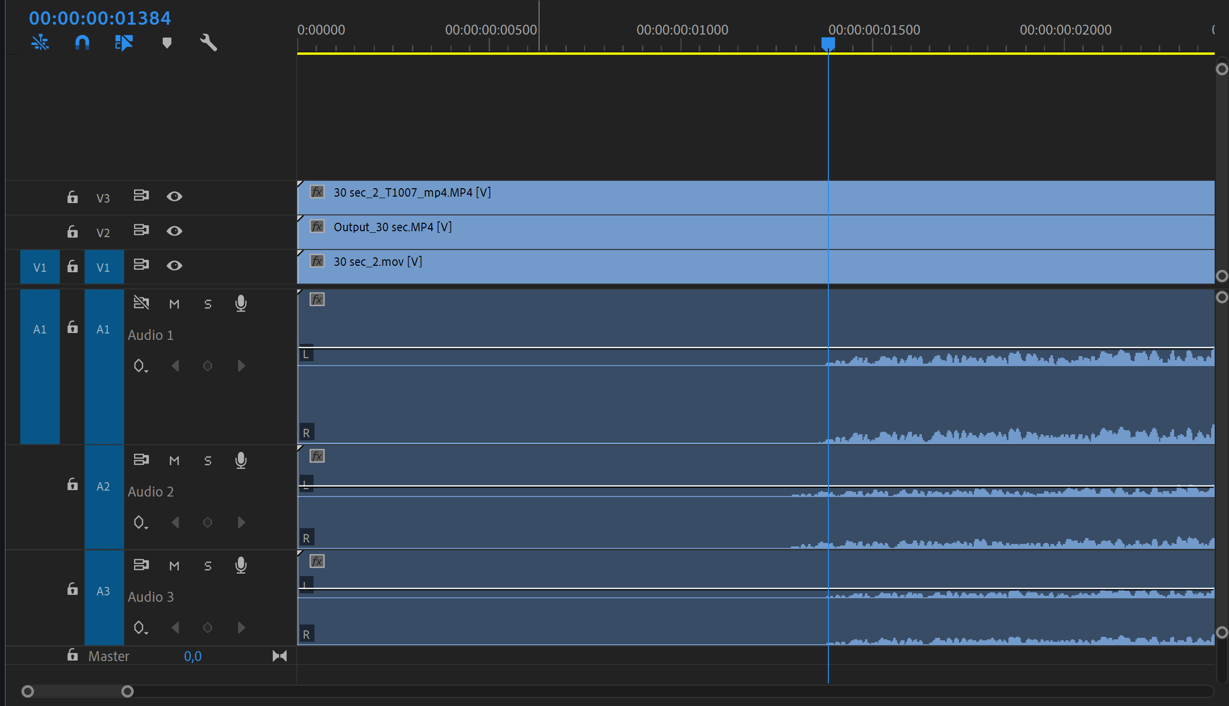

All 3 in one sequence look like this for me:
Where V1 belongs to A1, V2 to A2 and V3 to A3.
If you do the same and you see different results, i suspect that the difference we have is some sequence settings. In this case, i'd ask you to kindly provide the adobe premiere project on the gdrive link we used before.

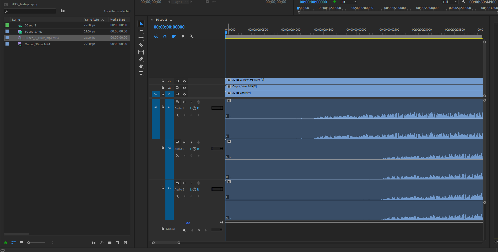

Post by Mahmoud Rady »
Hey Emcodem,
I've downloaded your package and imported them to Premiere. screenshot attached.
regarding the sequence setting, after importing the clips, right click on the first clip and select new sequence from clip to create a sequence matching my clip then I add the other 2 outputed clips. "premiere project uploaded".
