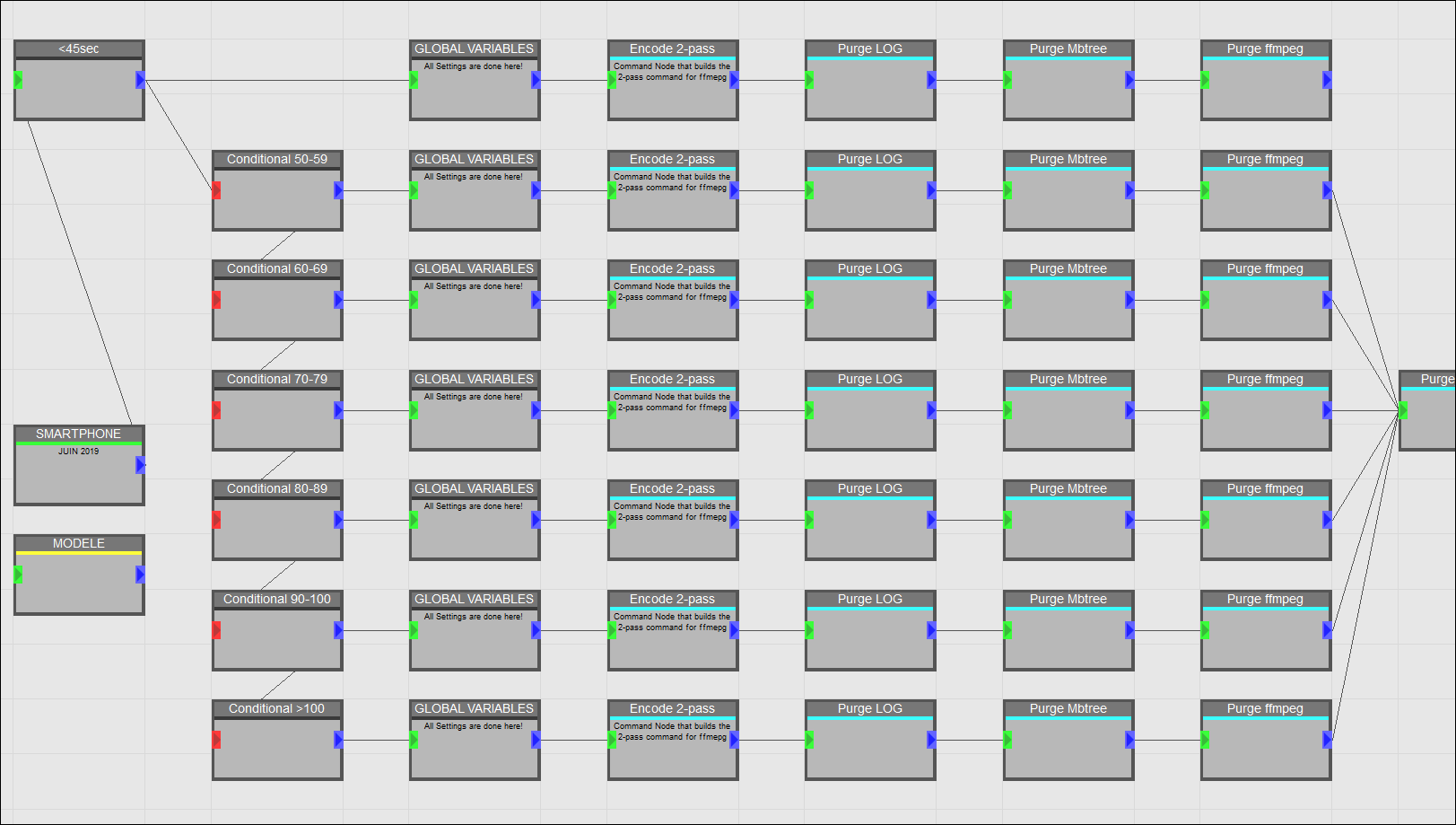

Hello Pogle,
Do your production files have almost the same duration?
- If yes, maybe you could create and use just 1 encode setting for all archives with a good value quality/weight (2 or more pass will be better)
- if no, you could create several encode settings according to several duration groups( 0 to 20 min -> setting 1/ 21 to 50 min -> setting 2, etc)
I created one with this kind of workflow :
In this way, you always use the better encode setting :)
Hope it gives you ideas :)
cheers.

@momocampo: Hello and thanks for your proposal! Our input files don't have a predictable duration. It varies from short takes to complete movies. What is the idea behind your procedure? Is it to apply more compression to longer files or to speed up encoding of long files?

Hello @Pogle,
The idea is to have the best encode setting to reach the same weight. I "aim" a 6-7 Mo file but I can't use the same setting with several duration. So, if I cut my workflow with different duration, I obtain the best encode setting according to the duration and a weight.
It is just an idea, depends of what you looking for, what is your priority : quality or weight? or both ? :)
