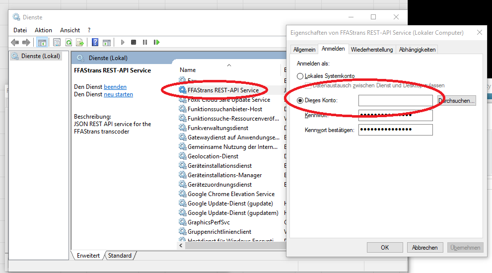

Hey Ghatis,
as you run ffastrans as a service but execute the batch as logged-on-user, your problem is most likely a permission issue.
What credentials is your ffastrans service running as? - try to set the service credentials to the same as you type when logging on to windows.
As far as i see in your batch, you set "chemin" to a UNC path. Chances are very high that your problem is that your ffastrans service does not have access to this UNC path (chemin).
Also it is a good idea to do some logging when working with batches (or any other self-developed program). You can for example read your ffmpeg's output when adding this at the end of each ffmpeg command:
2>> c:\temp\ffmpeg_log.txt
From the current perspective, i suspect that you will read an error message from ffmpeg in ffmpeg_log.tx like "no such file or directory" - as it does not have permissions to read from the specified UNC share.
For learning purposes, open "services.msc" and make sure ffastrans is running as the same user as you are logged in in windows:
After you made it work with the same user that you log on in windows, you need to find another account that can access the UNC share but that's password don't change ever and let the windows service run under this credentials.

Hi emcodem
yeahhhhh it works !!!
Thank you so much for your patience and your time it help a lot !!
