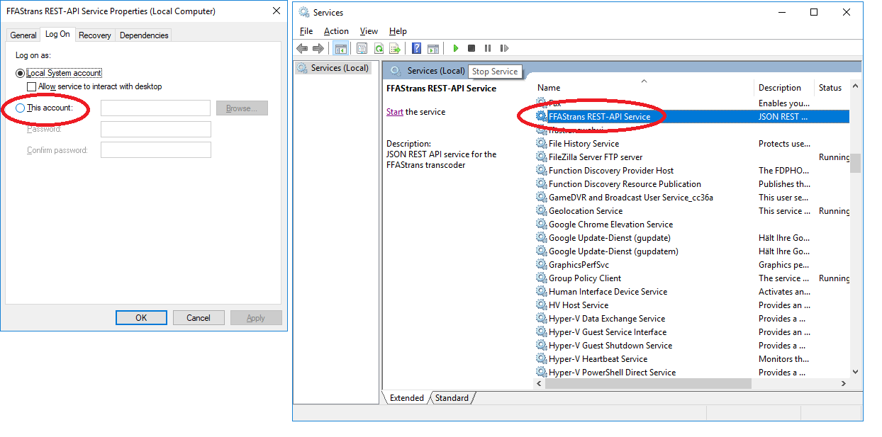

Well I retry my APPLE PRO RES issue and I found. If the ffastrans rest service is installed, impossible to encode trough the network (nas). If i desinstall rest service, it works well.
With FFASTRANS webinterface it should be same thing but I don't succeed to access at my nas. I edited the admin config but I don't succeed (I posted a message in webinterface post).
Overall, not possible to submit a file through network when rest service is installed.
Re: Can't recognize Pro Res codec?
Hey Benjamin,
looks just like permission issues. After installing the service, did you edit the windows service it and set the correct credentials?
You know, running as application uses the rights of the logged_in windows user, while windows services run as SYSTEM user by default. So either your NAS is configured for EVERYONE rights or you set the credentials in the
windows service.
But take care not to specify a user account that's password will change over time, otherwise the service will continuously lock the user.
I know it is a little confusing, but setting ffastrans API as windows service actually causes everything to run as a service - e.g. all encoding jobs run with the credentials of the windows service

Thanks for your explanation, but I checked and I have the same settings than you (Local system account).
I tried to check "this account" and configure with administrator log and pass but impossible to start the service after that(All the workstation are on a domain but this is the administrator log and pass for this domain that I tried).
I checked also my NAS rights and it is set to "everyone" with full control.

Hey Benjamin, sure i had success accessing files as a windows service... i do this very often with different services.
This is very connected to the thread in the Webinterface i just answered. No worries, we will get you there if you just don't give up working on it.
If you still have troubles, please make a drawing from networking perspective about your server, clients and storage.
In case the service does not start when you applied credentials to it, make sure the username you entered is member of the administrators group on the server. Don't use the local administrator at all, create a special user for it, log on with this user to the workstation and check if you can open the network path (without mapping a network drive) without a password promt - as suggested in the webinterface thread.
