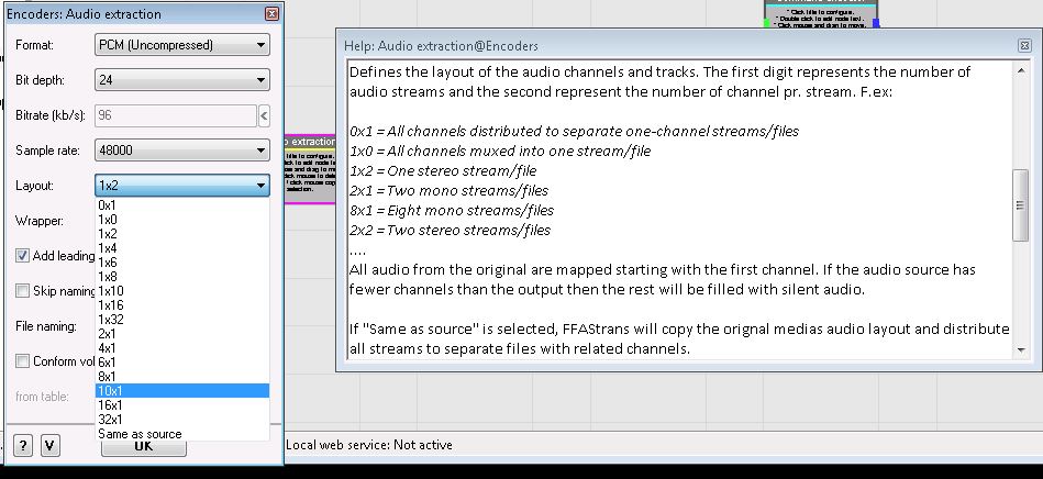

Please suggest, if I have source file with 8 mono tracks, is it possible to extract four stereo pairs (Mono Audio Track 1&2 = 1st Stereo Pair, Mono Audio Track 3&4 = 2nd Stereo Pair, Mono Audio Track 5&6 = 3rd Stereo Pair, Mono Audio Track 7&8 = 4th Stereo Pair) using Audio Extraction encoder option? In audio Layout option, I haven't found option to extract 2x2 Stereo streams, but in help you have mentioned the same, Please find below screen shot.
Audio Extraction.JPG (85.55 KiB) Viewed 25070 times
Thanks,
Vijay
Re: Command Executor Issue
Thanks for notifying. It will be addressed in the next version.
