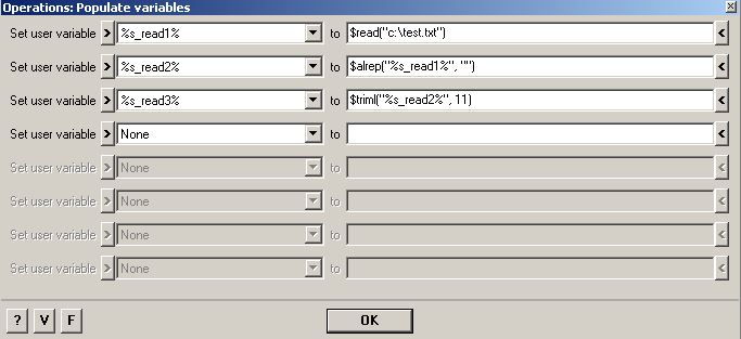

Hello Thomas,
Well, emcodem was, as usual, quicker as I but you can also do with "classic" populate variable like this :
You will obtain only your number.
