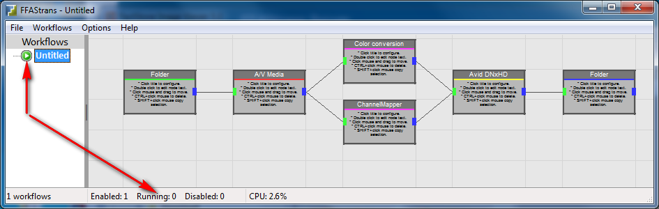

I'm sorry it's must be the dumb question but I can't to start no one workflow.
Fresh downloaded v.0.7.7, only one simple workflow: the icon is green but "Running:0" at dashboard.
I've got the very same results on Windows7 x64 Enterprise and on Windows Server 2008 R2 (x64).
There is no logs or error reports at all in the Processors\.cache\wfs\ folder, only the current .ini copy.
What am I do wrong?
UP. Same time I can to start this workflow .ini with v.0.7.2 if I copy it.
screenshot >>
workflow .ini

As one can see at the screenshot, v.0.7.2 and v.0.7.7 are running simultaneously at the same PC with the very same (copied) workflows. But v.0.7.7 have zero of running workflows and both are running in v.0.7.2. There is exactly the same file set in both v.0.7.2 and v.0.7.7 \Processors\ folders. And, finally, yes, I've disable my antivirus, but obviously it's doesn't matter at all.
So, there is a pretty weird situation.
Screenshot (clickable):
