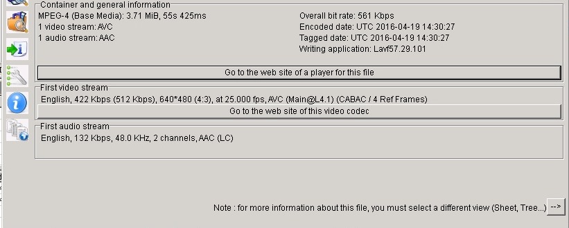

I am trying to create h264MP4 with constant A/V bitrate, but my output is always variable. I have tried both the custom FFMPEG and Encoder MP4 options.
I am using below FFMPEG command.
-c:v libx264 -s 640x480 -aspect 4:3 -b:v 512000 -minrate 512000 -maxrate 512000 -bufsize 512000 -pix_fmt yuv420p -coder 1 -flags +loop -cmp chroma -partitions +parti8x8+parti4x4+partp8x8+partb8x8 -me_method 4 -subq 6 -me_range 16 -g 15 -keyint_min 1 -bf 0 -intra -refs 4 -sc_threshold 40 -i_qfactor 0.71 -b_strategy 1 -qcomp 0.6 -qmin 10 -qmax 51 -qdiff 4 -direct-pred 1 -fast-pskip 1 -movflags +faststart -vprofile main -vlevel 4.1 -q:a 0 -c:a aac -b:a 128000 -ar 48000 -ac 2
My output is as per below screenshot.
Every file has different A/V bitrate.
Please suggest if there is any option to create constant A/V bitrate.

Is this an example that works when using ffmpeg command line but not when using the "Custom FFmpeg"-encoder in FFAStrans?

I have tried both ways, output was same. If I removed -q:a 0 then I will get audio bit rate around 126 Kbps.
