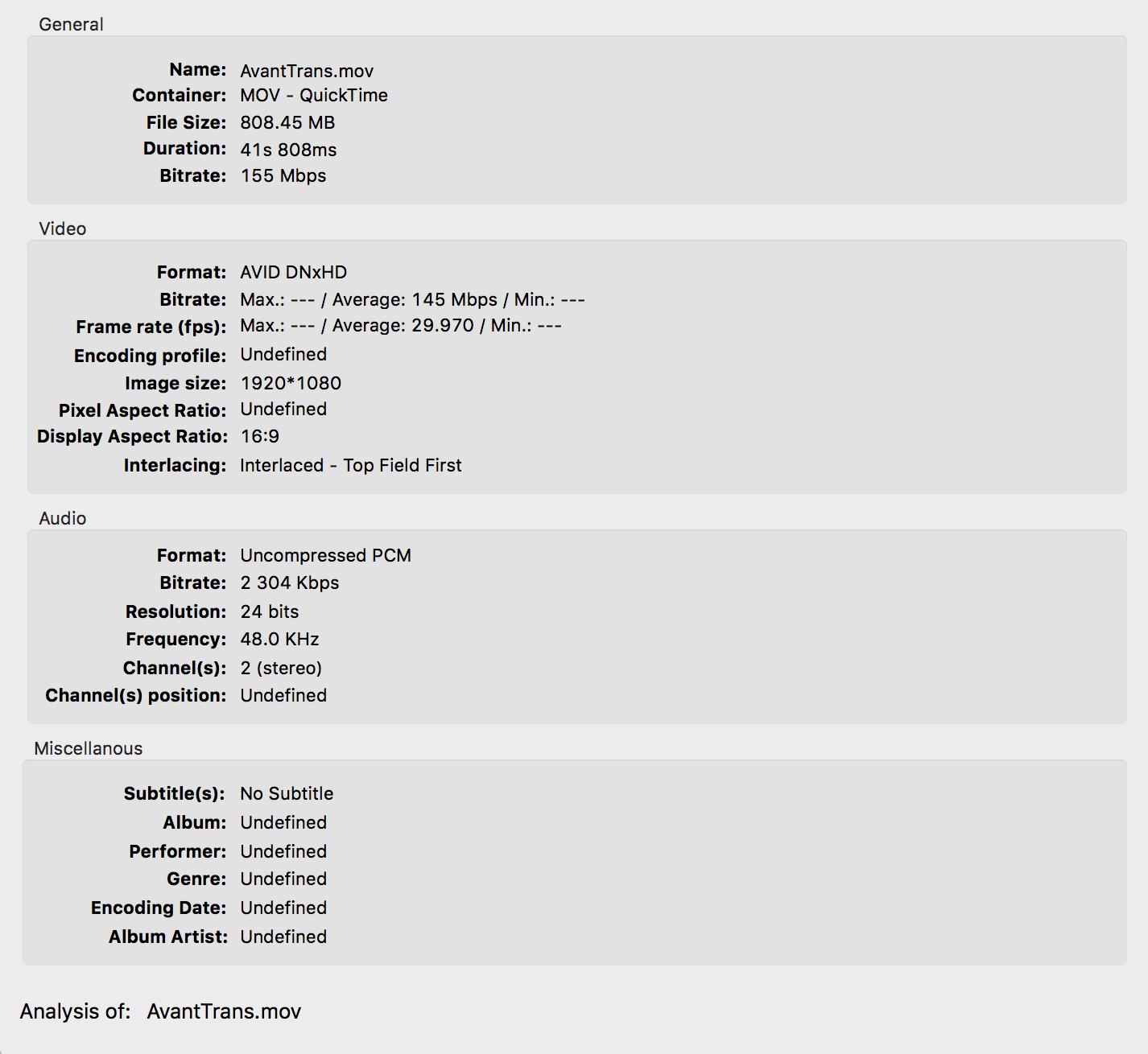

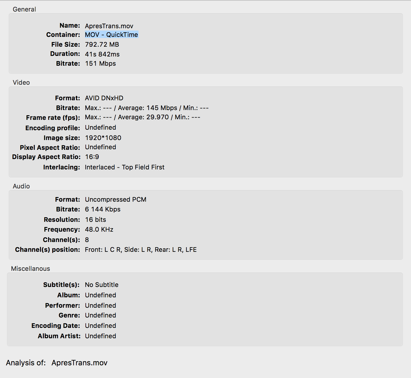

Now, I have to transcode some files back from H264 to Avid DNx145. The video part work great, but the audio doesn't work so well. I don't know how to explain it, but everything end up in the first 2 channels and not sounding correctly. When I open the file in a software, like VLC, it work great. But when I open it in my hardware (EVS server), it doesn't work properly.
I did 2 screens shots, one of a file that is working,
and the one after being transcoded with FFAStrans.
I also tried to use FFmpeg to encode DNx and it didn't work. I used dnxhd for the video codec, I'm not sure if this is the correct setting,
Thanks for all your help !
