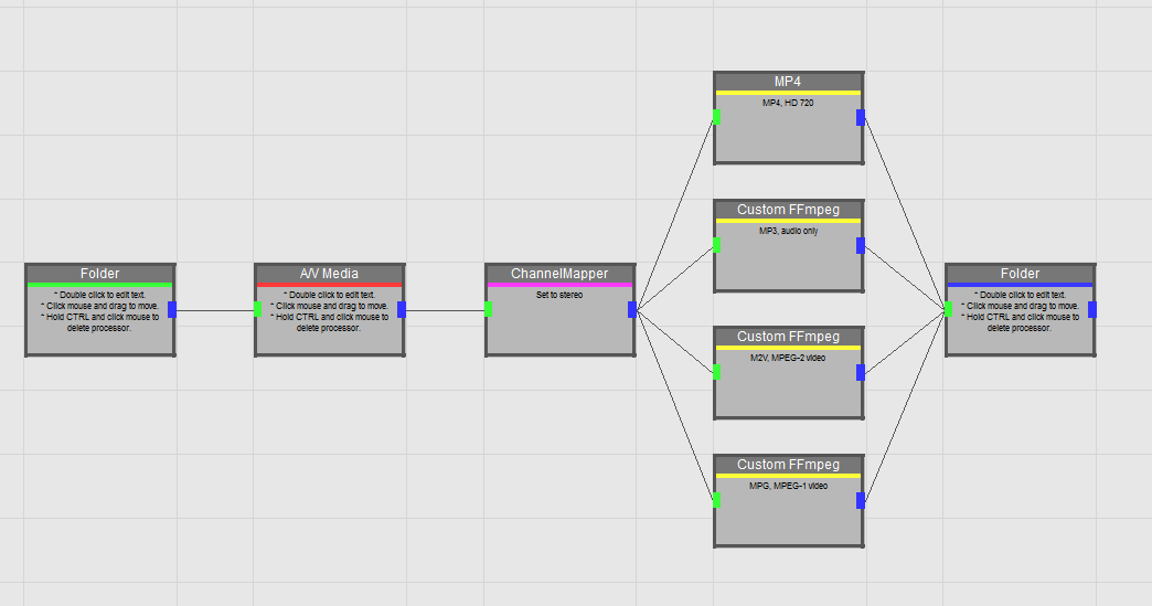

Anyway, your workflows will benefit much from the upcoming 0.6.0 version of FFAStrans as you only would need to watch and decode the files once and then branch it to 4 different encoders:
