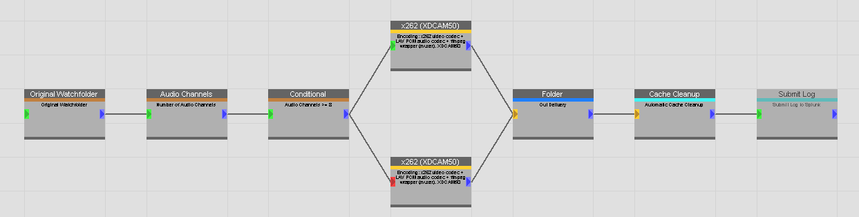

Well, at the end of the day, you just need a way to give a basic level path to then calculate the recursed path.
In this case, we can create a new variable called %s_my_recursed_path% which we're gonna use as our reference for the watchfolder when the job isn't triggered by the actual monitor node (i.e via API or manual submit by right clicking).
Then, we're gonna use that one to recreate the folder tree.
First, create a Populate Variable node and create the variable %s_my_recursed_path%.
Set my_recursed_path equal to the path to the watchfolder you would normally have, in my case the input path of the watchfolder is
M:\Media Ingest\Avisynth_Server1\Node1\x262_in
which means that in the populate variable I have
%s_my_recursed_path% == $replace("%s_original_folder%", "\Media Ingest\Avisynth_Server1\Node1\x262_in", "")
When you then create a delivery node, put the path you want the files to be delivered to there and append the new recursed path variable.
In my case:
M:\Media Ingest\OUTPUT Avisynth Server 1\Node1\%s_my_recursed_path%
In attachment you're gonna find a workflow with the example you're looking for.
x262_sp1.json
(16.48 KiB) Downloaded 1490 times
To make it work with your use case, the populate variable would be:
%s_my_recursed_path% == $replace("%s_original_folder%", "\01_Online", "")
and then the delivery node would be:
Y:\01_Offline\%s_my_recursed_path%
