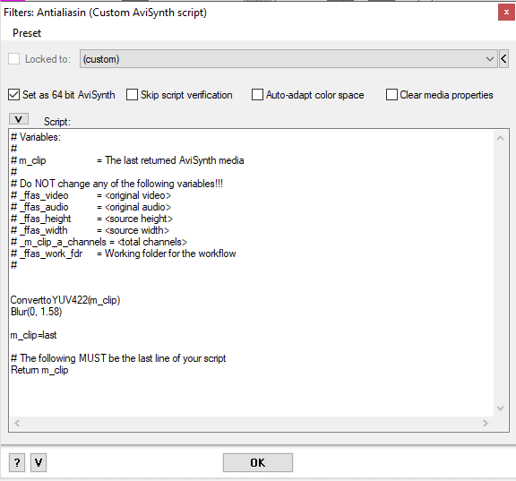

If it's just to avoid introducing aliasing while downscaling and interlacing progressive UHD clips to FULL HD interlaced clips, then you could just blur vertically and it will be just fine.
To do that, in the Custom Avisynth Script box just write:
ConverttoYU422(m_clip)
Blur(0, 1.58)
m_clip=last
return m_clip
also make sure to untick all the tickboxes other than the "Set as 64bit Avisynth" one, like this:
Screenshot from 2024-10-30 17-08-30.png (26.22 KiB) Viewed 10896 times

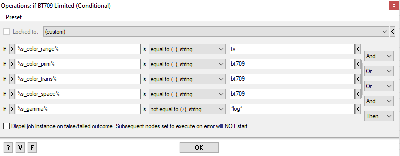

As for clipping, you can use the Safe Color Limiter node instead and potentially you could stack it after a conditional so that it only clips when the clip is BT709 and is limited tv range, like so:
Screenshot from 2024-10-30 17-09-53.png (25.43 KiB) Viewed 10896 times
Screenshot from 2024-10-30 17-10-21.png (5.1 KiB) Viewed 10896 times
if the conditional is true, then it will go through the node, otherwise if the conditional is false you can just make it go through the encoding node directly and let the filter_builder take care of the conversion for you.
