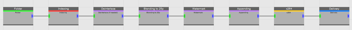

Screenshot from 2024-07-01 12-31-58.png (7.51 KiB) Viewed 40784 times
In the new workflow, we're using the A/V decoder to specify our desired output
Screenshot from 2024-07-01 12-32-39.png (15.17 KiB) Viewed 40784 times
followed by a deinterlacing step that deinterlaces the sources (if needed) and a ConvertFPS(25) step that brings everything to 25p before adding the watermark and then appending the media.
You can find the workflow in attachment, please change it according to your needs (i.e according to what the specs of L1 NIEUWS EINDKAART YOUTUBE 2024.avi are).
