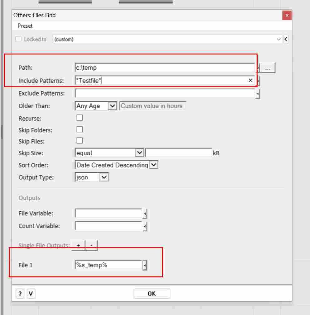

My first thought however is that there is the files find plugin processor, it is kind of best friend with the job scheduler feature :D
In this case, files find would set the variable s_temp (you can use s_source instead of course) to the FIRST found file that matches the include filter:

Sorry, but I don't get it.
I installed the plugins and configured the "Find Files" with %s_temp%. But the e-mail-processor keeps sending mails with the attachment "s_temp.txt", not "testfile.xlsx".

So you want to make sure that files find works as expected, e.g. %s_temp% has been filled with a valid filename.
While you build your workflow you can just connect a populate vars processor after files find and let it set %s_success% to %s_temp% so you can see in the "outcome" field of the jobmonitor what the variable contained. Did you actually "create" the user variable s_temp in the variables window (it might not work to use "non existing" variables)?
Once you are convinced that s_temp contains the filename, you can test if it now sends the email as expected, this should work.
After that, if you like you could insert a conditional after the files find and check if
$exists("%s_temp%") = 1
You could then insert a second email processor at the end, rightclick it's input pin and set it to execute on error, then connect the output of conditional to the 2 email processors (one for success path, one for error path)
