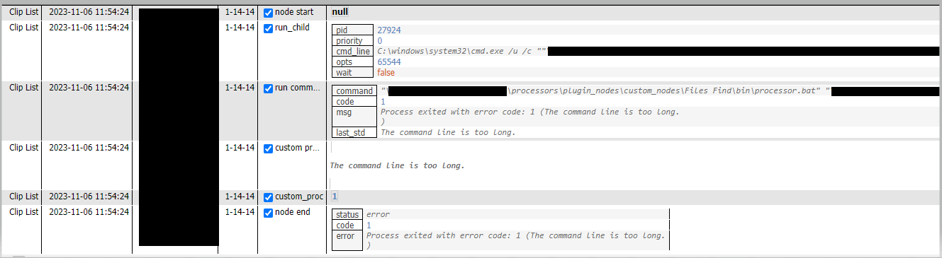

Here's an example from the log:
When pulling, say, 50 files from web UI the Files Find executor fails with:
C:\windows\system32\cmd.exe /c ""\\FFASTrans\processors\plugin_nodes\custom_nodes\Files Find\bin\processor.bat" "\\FFASTrans\Cache\\20221107-0825-2940-6f07-89b799e0f26f\20231031-1134-4714-0a13-142f35fb7b43\1-14-14~231031113452604~15132~20231010-1212-0548-40f2-34939b166129~plugin_htmlgui.inputs.json" "["\\\\QUITE-LONG-UNC-PATH-WITH-SEVERAL-FOLDERS\\PROBABLY-A-LONG-FILENAME-1.MP4","\\\\QUITE-LONG-UNC-PATH-WITH-SEVERAL-FOLDERS\\PROBABLY-A-LONG-FILENAME-2.MP4"]""
etc... x50 files
it fails with:
"Process exited with error code: 1 (The command line is too long.)
