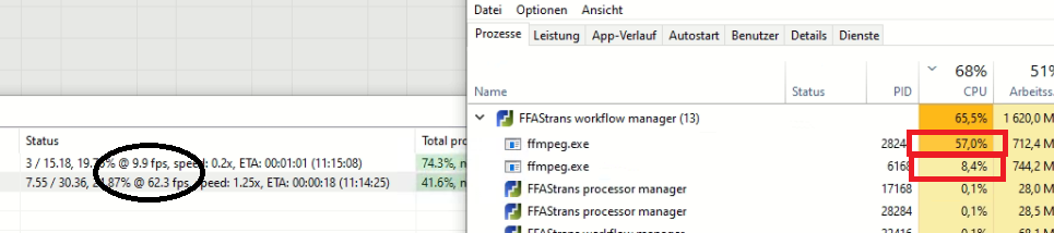

sorry for the delay, i first tried on my laptop but was not able to reproduce your results so i needed to wait until i get hold of a fast server to retry.
After all, i cannot reproduce your result that no filters is anyhow slower than filters. In fact, using a 30s source file, the "no filters" would finish encoding before the "filters" even started encoding at all.
Besides the starting time, "filters" for me runs significally slower than the other. In task manager i see exactly what i was talking about: some filter causes the stuff to run on a single core more or less:
I used a 720p50 source but i don't think the resolution of my source matters.
@mrazik, can you confirm your results and maybe upload a source file that you used for testing?

yeah, I think I made a mistake in the tests :roll:. Just for sure I ran the transcoding several more times and here is the result:
filters:
- Indexing (20s) - SSD looks to be a bottleneck
- A/V Media (183s)
- Deinterlace (25s)
- Timecode (2s)
- FPS (3s)
- H.264 (791s/0.17x) - not sure why it's running only to 30% CPU
no filters:
- H.264 (238s/1.2x) - up to CPU 95%
You can find the test file in https://www.dropbox.com/s/3v2w94797o4pb ... 1.mxf?dl=0 (5mins and it has 9GB).

Only when you use A/V decoder, the "disk speed" can matter at all realy. The "indexing" step is usually superfluous, it is basically only for repairing special defects in files but the avisynth ffms2 plugin requires to index always. Also, depending on the source file, it can happen that A/V decoder decides to generate an uncompressed version of your source file in the cache directory which would of course slow down the overall process massively and uses your disk speed basically 100%, maybe 50% for a very fast M2.
You'd need to find a way to get rid of the A/V decoder. I believe in your case, you should just use the builtin encoder procs instead of a custom h264, they will automatically insert any needed deinterlace or fps conversion stuff (as well as color stuff, audio stuff etc) into the finally calculated ffmpeg command internally. Thats actually one thing where ffastrans is pretty good in, to smartly calculate the needed ffmpeg cmd.
Using ffmpeg only without avisynth should usually get you rid of the single core filtering...
