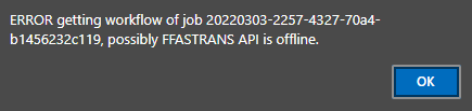

Having an issue with a new farm setup and accessing job details through the webinterface.
Running latest versions of both, farm setup is working as expected, with 4 computers sharing the work, while one computer hosts the FFAStrans program and is the one running the Webinterface. Webinterface shows all of the jobs correctly, but trying to view any of the job details, shows the error seen in the picture attached.
Any ideas on the cause and a fix?
@failsafe5000
The log viewing is done by direct file access instead of using the ffastrans API. If your ffastrans files are on a NAS, you'd need to give the webinterface service credentials that can access that NAS as well.
For debugging, you can stop the webint service and start server.exe by just doubleclick it. You will then see corresponding error messages in the commandline window when trying to open a log. If it works when you start server.exe manually but not as service, you just need to alter the credentials of the webint windows service.

emcodem wrote: Fri Mar 04, 2022 8:02 am @failsafe5000
So got it to work. It wasn't a permission issue, but a weird issue with how the Farms and the Main computer (where the FFASTrans install and webinterface are running) were loading FFAStrans.
Basically the main computer had everything inside of a FFASTrans folder, with that folder shared, then the farms had that folder mapped directly. Initially looking at the error messages, showed the webinterface trying to load the X drive for job details (the drive letter I had used on the farms), and it was looking for the Processors folder right after the drive letter. So to fix the issue, on the main computer I created a new drive, gave it the letter F, and moved the FFASTrans and Webinterface install to the top level of that drive. Then changed the Farms network drive letters to F as well. After doing that, everything is now working.
