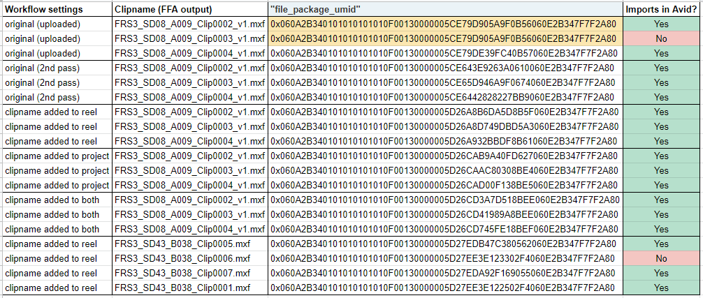

Ok so I tested transcoding the same 3 files with the %s_original_name% added to the tape name, then again with it just added to the project name and then a third time with it added to both just for good measure. All tests resulted in unique "file_package_umid" for every file which is great but then sometimes just running the transcode again with the same settings can do this.
So then I run a whole batch with the %s_original_name% added to the tape/reel name and some reels are flawless but several have issues. I've run ffprobe on one of these and found that the "file_package_umid" is not the same as the file it is wrongly referencing. In this case when I isolated the offending mediafiles then imported, it wrongly referenced a clip that was not in seqeuence so it appears it can happed to any other clip in the reel.
See below that clip6 wrongly references clip1 from that reel but they do not have the same "file_package_umid".
So far the change to the workflow seems to have stopped the umid conflict but I'm still having the same import issues :S
I'm really surprised that this isn't a more widespread issue as I would have thought FFAStrans would be used for Avid media by many users.
EDIT:
While the "file_package_umid" is unique, I started comparing other fields and found the "material_package_umid" of clips 6 & 1 are identical. Then I found this discussion on bmxlib:https://sourceforge.net/p/bmxlib/discus ... it=25#e8c8
If I'm understanding this thread correctly, it seems that an important umid that Avid uses to identify files is calculated based on the system clock so that files encoded in parallel could be conflicting. That would be diasterous in a farm like setup such as this! Most of the jargon goes way over my head but does this make sense to anyone else?
I'm thinking perhaps even if I just limit each machine to a single job at a time it could reduce the probability of jobs starting at the same time if the system clocks aren't all perfectly synchronised. In theory running one machine with 1 job at a time would make it impossible for time based conflicts so I'll try that on a small batch when I get the chance.

Hey Vinny,
very nice finding in the bmx discussion group. I had a look in the source code of the mentioned part in libMXF/mxf_avid.c and i see there area already some hacks around this, so it looks like this topic did not come up the first time.
To be honest, i did not spend the time to check if the UMID's are valid after this patch, but for your convenience (not sure if you are able to do this), i applied the same patch as the user did in the BMX discussion and uploaded the resulting build here. You can use it and replace the default bmxtranswrap that comes with ffastrans for start. Please let us know if this solves your problem. If yes, i can probably create a patch that involves a commandline switch to force this behaviour and send them to bmx guys for merging (but they are not too active anymore ^^ so we probably better go with a custom copy of the source anyway)
https://drive.google.com/open?id=1dqwWf ... yjy6nvLY8e
Please know that the visual studio 2010 x86 redist is needed to run this build (i believe it is neccessary for the original build as well): https://www.microsoft.com/en-us/downloa ... px?id=5555
I don't really wonder that this only hits a few users, first there are not too many Avid users out there and only some of them use ffastrans. Second from this small number of users the chances that they run workflows that start in the same second is even smaller. Same for BMX users. The chances that anyone hits this problem AND is willing to invest the time to go to the bottom of the problems goes in direction 0 :-(
Let me know

emcodem you're a legend! I'll test this out as soon as I can.
I guess you're right about the number of users with this use case being tiny, I only found out about the program after searching for network farming solutions for quite some time of which there was not a lot to find overall on it's own.
Re: DNxHD encoding issues
Just to let you know, i just tested very quickly and found out that i could reproduce your problem with the same MP Umid being generated when 2 transwrapping processes start at the same time (it was hard to reproduce actually but 2 out of 3 mostly matched).
Using the bmxtranswrap version i uploaded before, the FilePackage UMID and the MP UMID seem to be totally different (unique), independently of the Project and Tape name and Time of day.

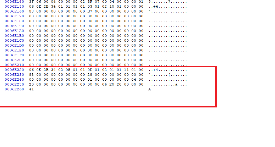

At the same time, i'd like to know if the last few bytes of the "too short" files in a hex editor look like this screenhot. ...i believe you could check only the last byte, it should probably always have the hex value "41" but also the whole surrounding bytes with all the zeros should look alike. If you dont have a hex editor installed, you can use my favourite "HXD" or use the online version hexed.it - it will not upload the file to their severs ;-)

Starting with the results from the hex editor:
3rd pass, file does not playback or import, does not end in 41
4th pass, file does playback and import, does end in 41 (with A as pictured above)
I couldn't find the logs for the failed export as there were many other folders but I'll keep running it until it fails again and upload. Are the logs from the successfull 4th pass of any use?
Great, the logs will hopefully give some insight.
It is not a surprise that the defective file from pass 3 looks different in hexeditor; this indicates that the transcoding process was interrrupted while it was running. What i didn't get by now if the duration of file from pass 4 (which looks good in hex editor) was OK or not. I wonder how files with shorter duration look like, also some ffprobe output from a working file with shorter duration might give some insight.
cheers!
