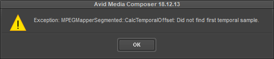

But when the clip is in the bin and you want to play it, the error "MPEGMapper Segmented::CalcTemporalOffset: Did not find first temporal sample." like the other posts before.
