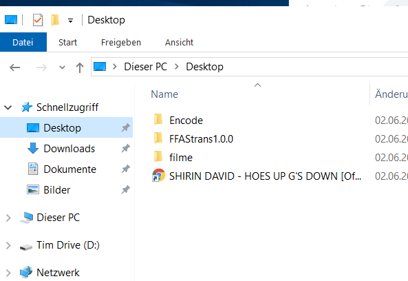

This is the Log after i connected via the Browser. It put me right to the Area where i can place files. The folder is the normal Desktop folder and i have on my main drive 100 of 119 gb free space so the Folder cant be this big.
Attached is a screenshot of my desktop folder
Sorry for the German windows and the Music video wich is in the German Youtube Trends.
I use this as example.
I just saw another Problem not only arent files showing up also are the folders wich are at the desktop arent showing up aswell.

Also whats this link on the Desktop, can you try to remove the link and try if it works then? If yes i'd like to know what kind of link it is

Also, can you tell me about the link on the desktop "SHIRIN DAVID" and if it changes the behaviour when the link is not there?

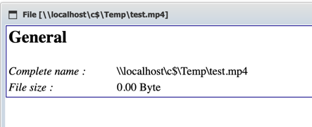

I'm getting issue with MediaInfo - when trying to get info in File Browser (local or UNC clip) - I get error message "ERROR getting mediainfo for file"
Versions:
- FFAStrans is 1.0.0.178
- Webinterface is 1.0.3
Weird is that when running the web server in devel mode (node server.js), everything is working, but when FFAStrans and Webinterface are running as services, it's not working.

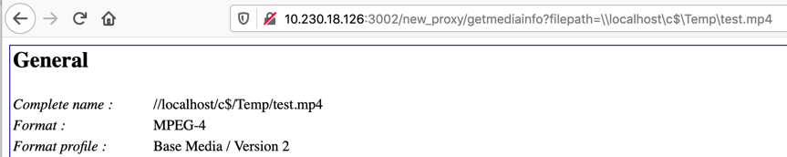

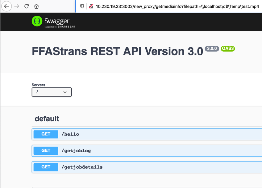

Next check was direct API GET to http://IP:3002/new_proxy/getmediainfo?filepath=FILE:
- standard mode - returns message "Error getting mediainfo"
- devel mode - return full HTML MediaInfo
Can you please point me out where could be the issue?
Many thanks!!!

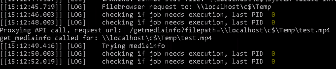

emcodem wrote: Fri Jun 05, 2020 12:10 pm 2: when you start server.exe and reproduce the issue, do you see interesting messages in the commandline?
This is from devel node - working
This is from started server.exe - not working - as it looks there is missing cmd to the server itself
emcodem wrote: Fri Jun 05, 2020 12:10 pm From the informations i currently have it could be anything, starting from credential issue up to a bug...

What I also found out is the difference between devel and server.exe when checking MediaInfo GET page (http://IP:3002/new_proxy/getmediainfo?filepath=FILE):
server.exe
devel
So it looks that "/getmediainfo" is not listed when running as server.exe or as a service....
