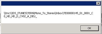

I am receiving below message while processing jobs on 0.8.0.2 version.
Once I click on OK, job start processing.

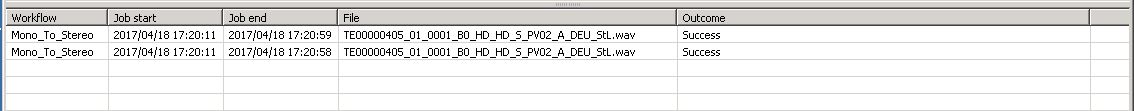

Please find attached workflow I am using, after completion of jobs I am getting two notification in status monitor window. Please find below screenshot for your reference.

Please suggest if there is any changes require in workflow.
Status Monitor.JPG (34.16 KiB) Viewed 19999 times
Can you please check and suggest.

Re: Two mono audio streams to one stereo audio stream
Oh that's a bad one! :oops:
I've updated to 0.8.0.3. Please upgrade.
Thanks for reporting! :-)
