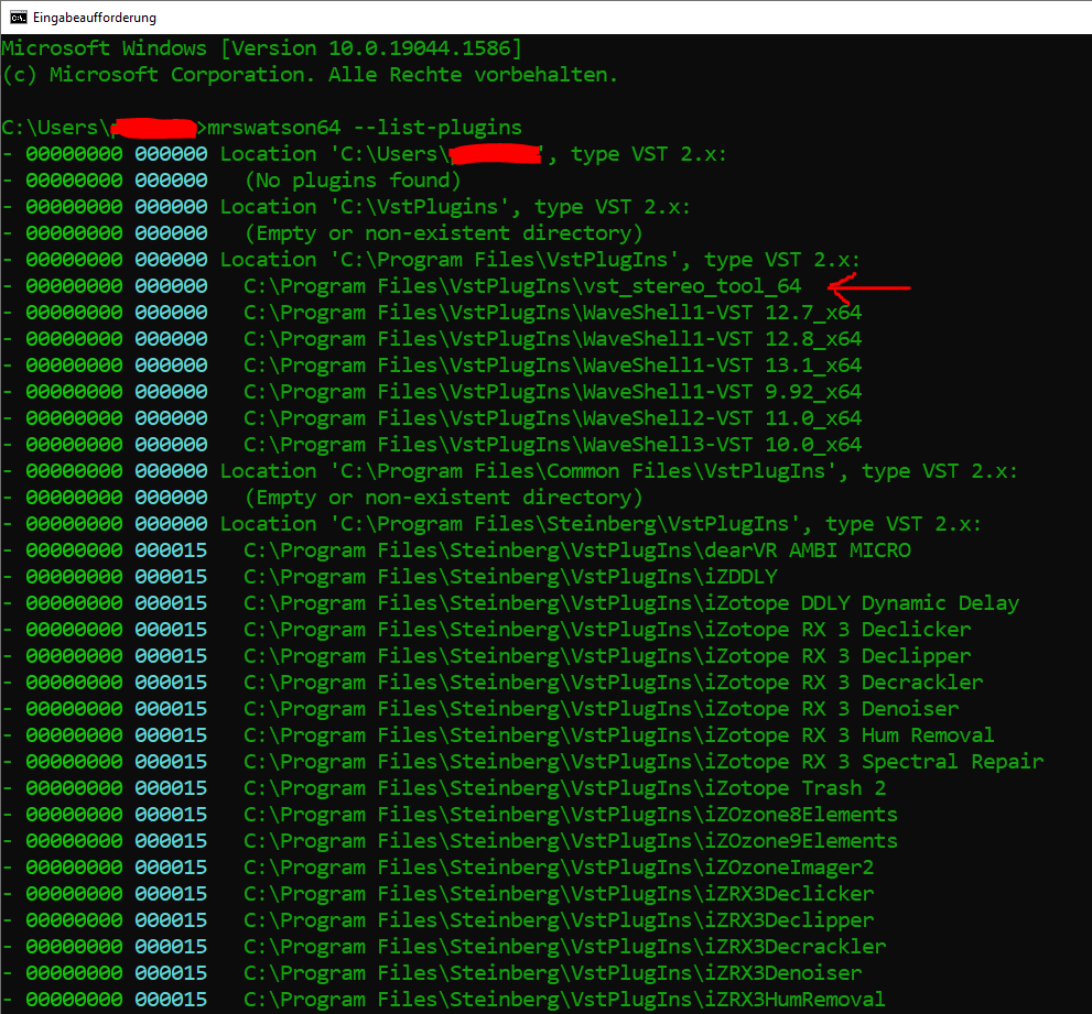

MrsWatson is installed correctly und it starts in the "cmd" (See Pic below) The Arrow marks the PlugIn I would use for the Process
I will use the 64Bit Version of MrsWatson.

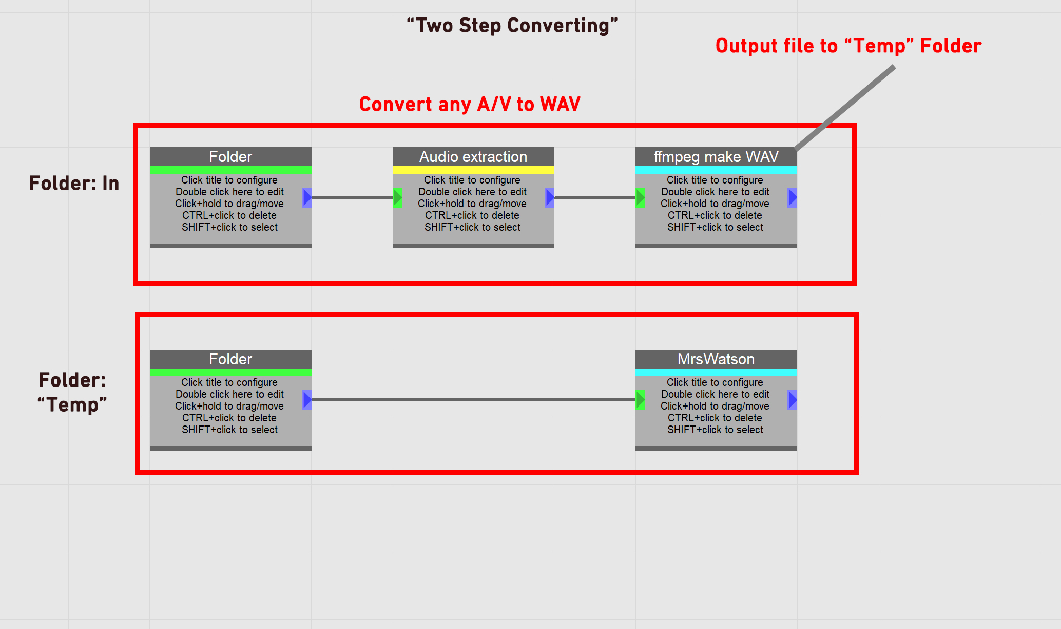

in the first Step of Converting (See pic) i just make a .WAV of any Audiofile. Because MrsWatson just can handle .WAV files.
In the second step i try to process the Converted .WAV with MrsWatson
IDK if this is the way to go.
If there is a possibility to make my Workflow in one step, that would be nice.
My Idea was:
- Convert any Audio to .WAV with ffmpeg Node
- Process the .WAV with MrsWatson -> .WAV Output
- Convert the processed Audio to mp3 320kbits CBR with ffmpeg Node
- Delete the .WAV Output of the Temp Folder (optional feature)
