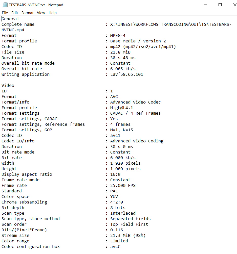

emcodem wrote: Sun Sep 05, 2021 1:20 pm I think we should try quicksync or nvnenc h264 encoder with paff to test out if paff is really the disturbing factor here.
On the other hand @Wayhu said nvenc was already tried, were you able to get a paff file out of it - so one that basically matches exactly the first mediainfo you posted from a working file?
I submitted a workflow using custom ffmpeg with codec h264_nvenc. I think this is close to the premiere result if you look at the media info, but it still doesn't work.
Create_TS_2.json
(8.3 KiB) Downloaded 9012 times
Re: mp4 like Adobe premiere result
OK thanks, great!
Unfortunately i cannot encode with your settings because obviously on Touring Cards they disabled interlaced encoding, those suckers.
Anyway, i see there is some stuff in your nvenc meiainfo that dont match the original video at all, e.g. M/N of the GOP and Bitrate. So this one is considered to be not very close to the original working file. Even the files that @francebb created for you before do not really match the working example's config, they are VBR and totally different bitrates than the input file.
Just for clarification: the working file sample is the one you uploaded from permiere, the ts version with 2 mp2 audio tracks, is this correct? So the working file's name is TESTBARS-TS.mpg, right?
As i cannot use the nvenc encoder currently because i only have touring available, i tried to create a quicksync version for you, please download it at
ffastrans.com/share go to "samples->h264_qsv"
Also, it would be good if you work without ffastrans to get your ffmpeg commandline done. It is much faster and more accurate this way as you see all the warnings and such from ffmpeg.
The commandline i used for this qsv encoded sample is:
ffmpeg -f lavfi -i smptebars=duration=10:size=1920x1080:rate=50 -f lavfi -i "sine=frequency=1000:duration=10" -map 0 -map 1 -map 1 -ac 2 -c:a libtwolame -ar 48000 -flags:v +ildct -top 1 -dpb_size 4 -profile:v high -level:v 41 -vsync:v cfr -pix_fmt yuv420p -g 25 -cbr true -r 25 -brand mp42 -async 1 -c:v h264_qsv -b:v 20M -minrate 20M -maxrate 20M -refs 4 -bf 2 -muxrate 20M c:\temp\10s_source.ts
Wahyu

emcodem wrote: Mon Sep 06, 2021 10:23 am OK thanks, great!
Usually M=3, N=15 but I don't know where to set M in h264_nvenc and I don't think it affects much, because when I try in premiere with different M/N the playout works.
emcodem wrote: Mon Sep 06, 2021 10:23 am Just for clarification: the working file sample is the one you uploaded from permiere, the ts version with 2 mp2 audio tracks, is this correct? So the working file's name is TESTBARS-TS.mpg, right?
yes, right!
emcodem wrote: Mon Sep 06, 2021 10:23 am As i cannot use the nvenc encoder currently because i only have touring available, i tried to create a quicksync version for you, please download it at
Okay, Thanks for info
The sample you sent is still not working.
