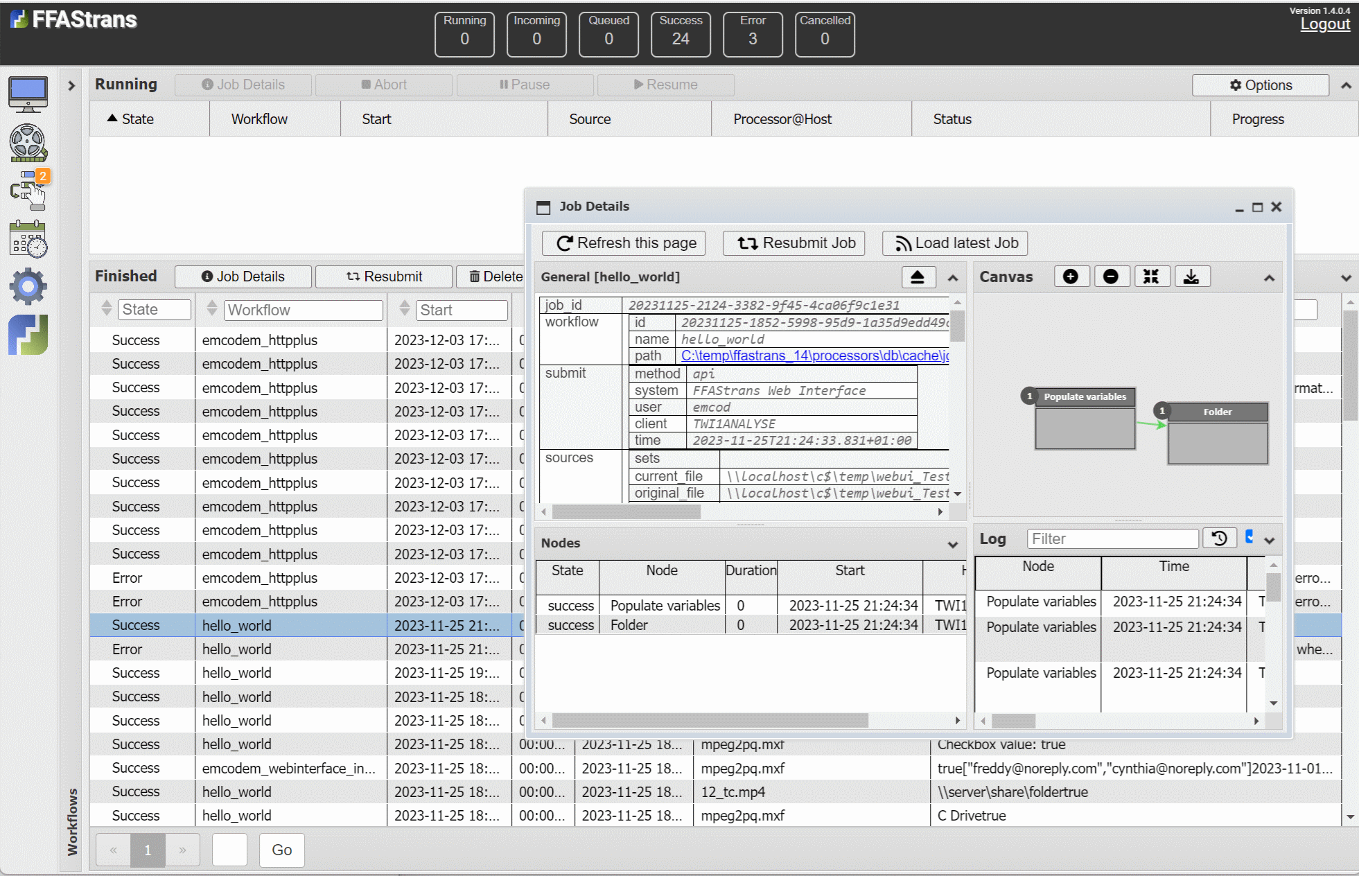

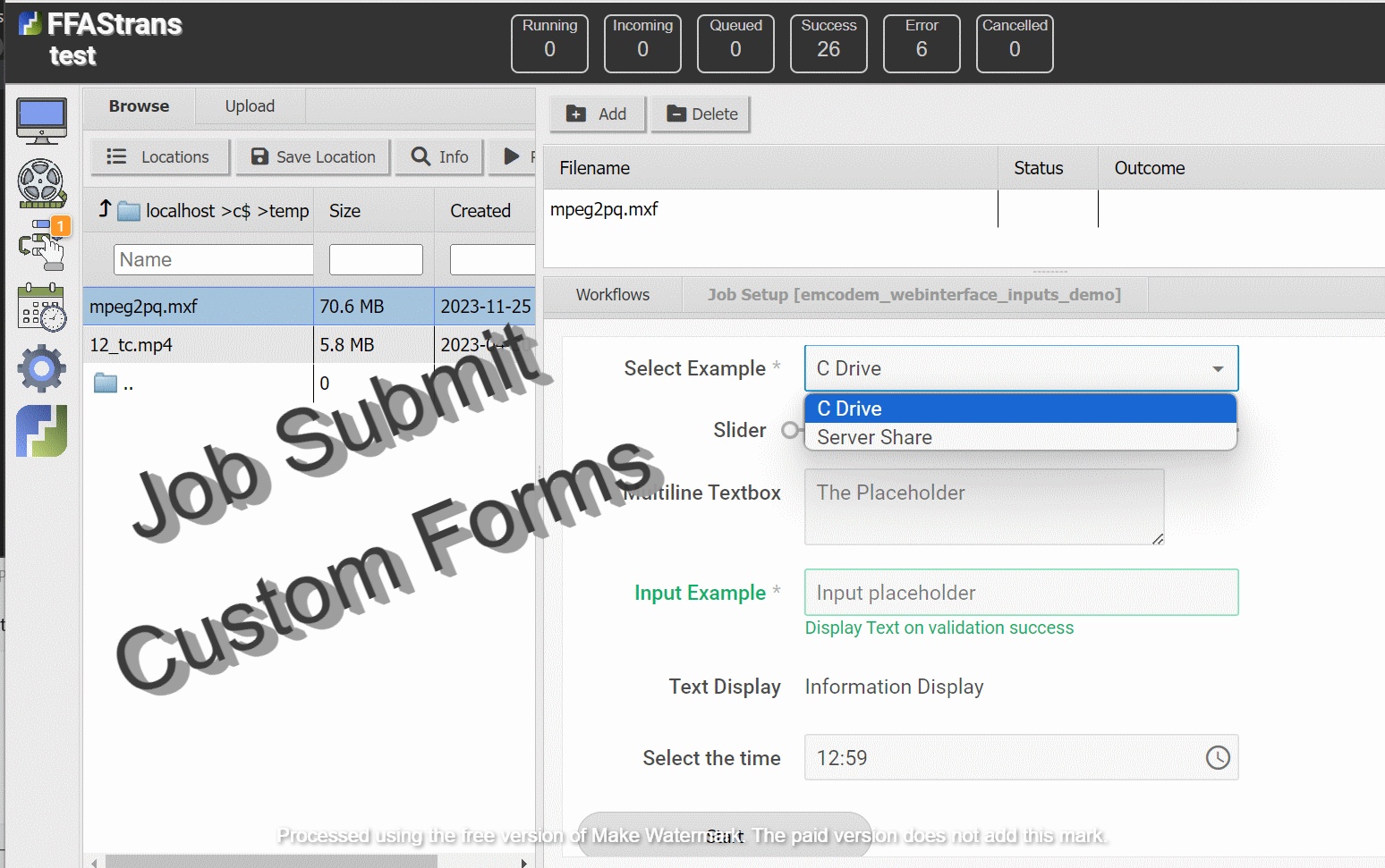

-) Submit Jobs by upload or server file browsers, along with userinput from webui to a user_variable of the workflow
-) Log viewer with highligting of useful information

[Start workflow instructions]
Workflows can be started by either uploading a file (it will be added to the file list automatically), by hitting the "Add Source" btn top right or by browsing for a file and doubleclick it. TIPP: you can add a URL to e.g. an rtsp stream using the "Add Source" Button.
After you have one or more files in the list top right, you can hit the "Start Workflow" btn (also top right ;-))
When adding a Source manually, take care that ffastrans is able to access the path as you enter it.
NOTE!! Please let me know if you are using the upload feature, it does cost a lot of efforts and i am not sure if it is helpful anyway.
[Job Submission with additional Variables]
Check out the Wiki on how to generate nice looking "Form" that allows users to fill in additional information like emails etc..
