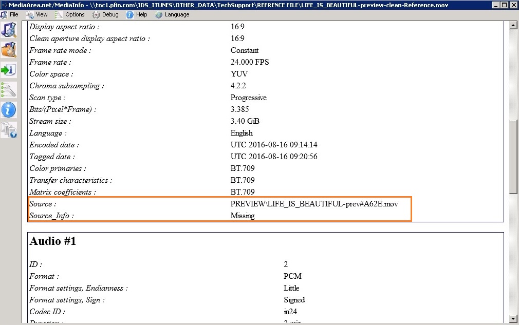

If I used above attached example I am getting output as per my encoding setting. I am not able to to play my original hi-res source file using QTReference file.
I have attached media info of source file and QT reference file which I have created using FCP. If you compare both the media info's you will get all the parameters equivalent to each other. Only difference I have observed is file size and one line added in reference file which is source file location. If I play QTReference file created using FCP I am able to play source file.
Please correct me if I am missing anything.

The QTSource function is needed to read QT reference files. It uses the QuickTime SDK to open the files, that's why you need to install QuickTime from Apple. FFmpeg cannot do this by itself, that's why QT reference files requires special treatment, because they are special.
Now, I'm not sure I quite understand what your post actually is about because the way I understand it, the workflow does what's expected. Is that right? Also, you seem to have a playback problem with our QT reference files?
