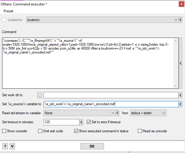

_Ilan wrote: Wed Mar 26, 2025 12:40 pm How to use a delivery block after a ffmpeg in a command executor.
When you're outputting the file in FFMpeg, don't write to destination, write here:
"%s_job_work%\%s_original_name%_encoded.mxf"
Then, in the "set %s_source% variable to" section of the command executor set it to your output.
Basically I mean something like this:
Screenshot from 2025-03-26 13-14-50.png (25.63 KiB) Viewed 29973 times
%comspec% /C ""%s_ffmpegx64%" -i "%s_source%" -vf scale=1920:1080:force_original_aspect_ratio=1,pad=1920:1080:(ow-iw)/2:(oh-ih)/2,setsar=1 -c:v mpeg2video -top 0 -b:v 50M -pix_fmt yuv422p -r 50 -acodec pcm_s24le -ar 48000 -filter:a loudnorm=i=-23 -f mxf -y "%s_job_work%\%s_original_name%_encoded.mxf""
From there you can use the delivery node.
Still, I very much suggest you the use of the built-in XDCAM encoder instead, not only it's developed in a way that it always produces compliant outputs , but an encoding node is much more than a command line executor, it goes through the filter_builder which creates the appropriate filterchain for every given input to produce the appropriate output before feeding the encoder. For instance, it takes care of things like chroma sampling, chroma location, matrix/transfer/primaries conversion, upscale/downscale, frame rate conversion and much much much more.
