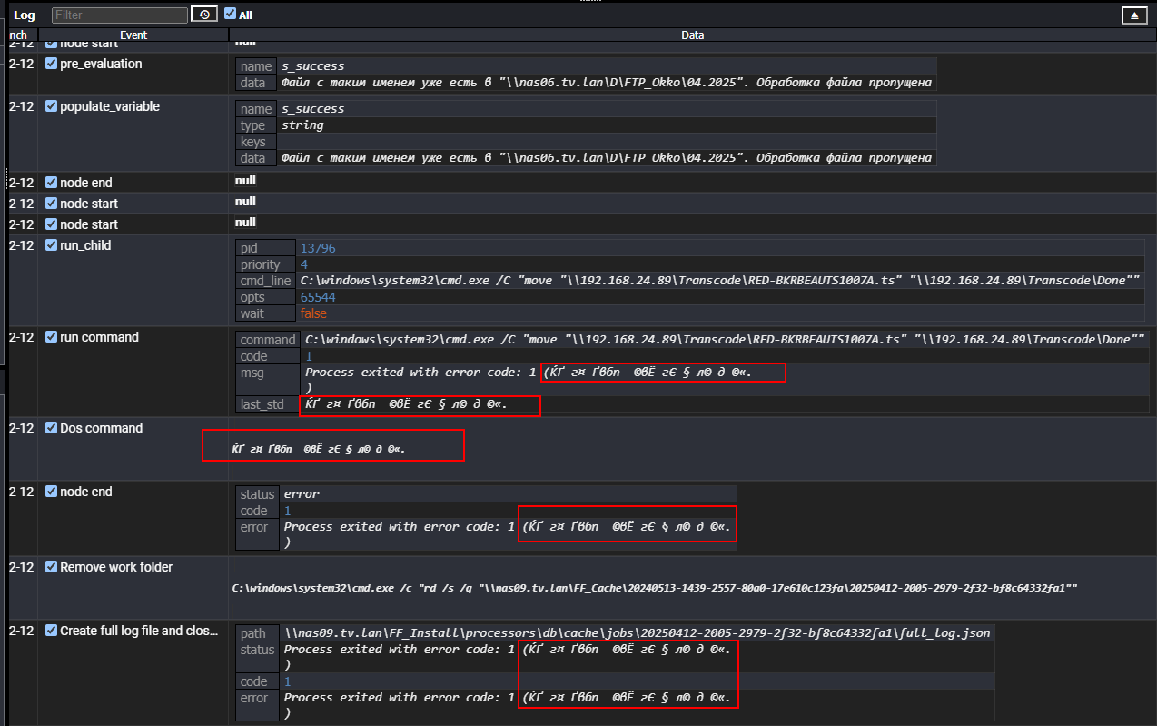

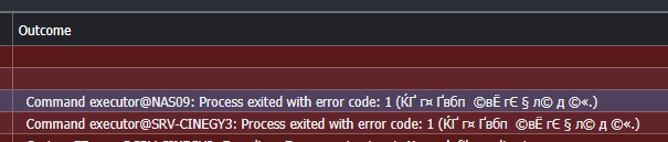

- Is there any way to make the populated %s_error% ouput message similar to the populated %s_succes%, so that it would be without that part “Populate variables@*ServerName*: ”?
- If cmd output is encoded in WINDOWS-1251, the web interface looks like this:
Is there any way to fix this?
@DCCentR sorry i should have answered much earlier. AFAIK there is currently no way to remove the portion you want to remove from error message.
