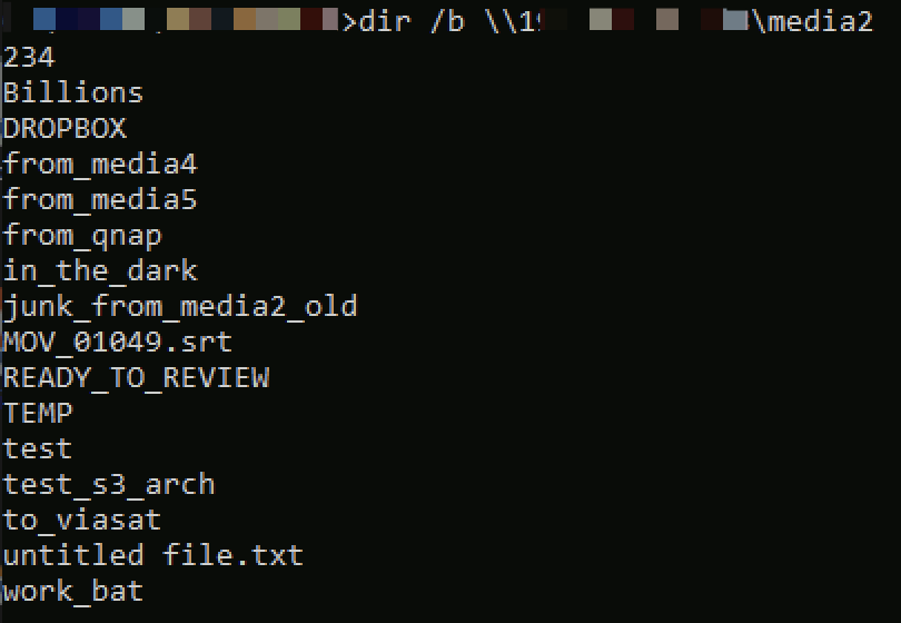

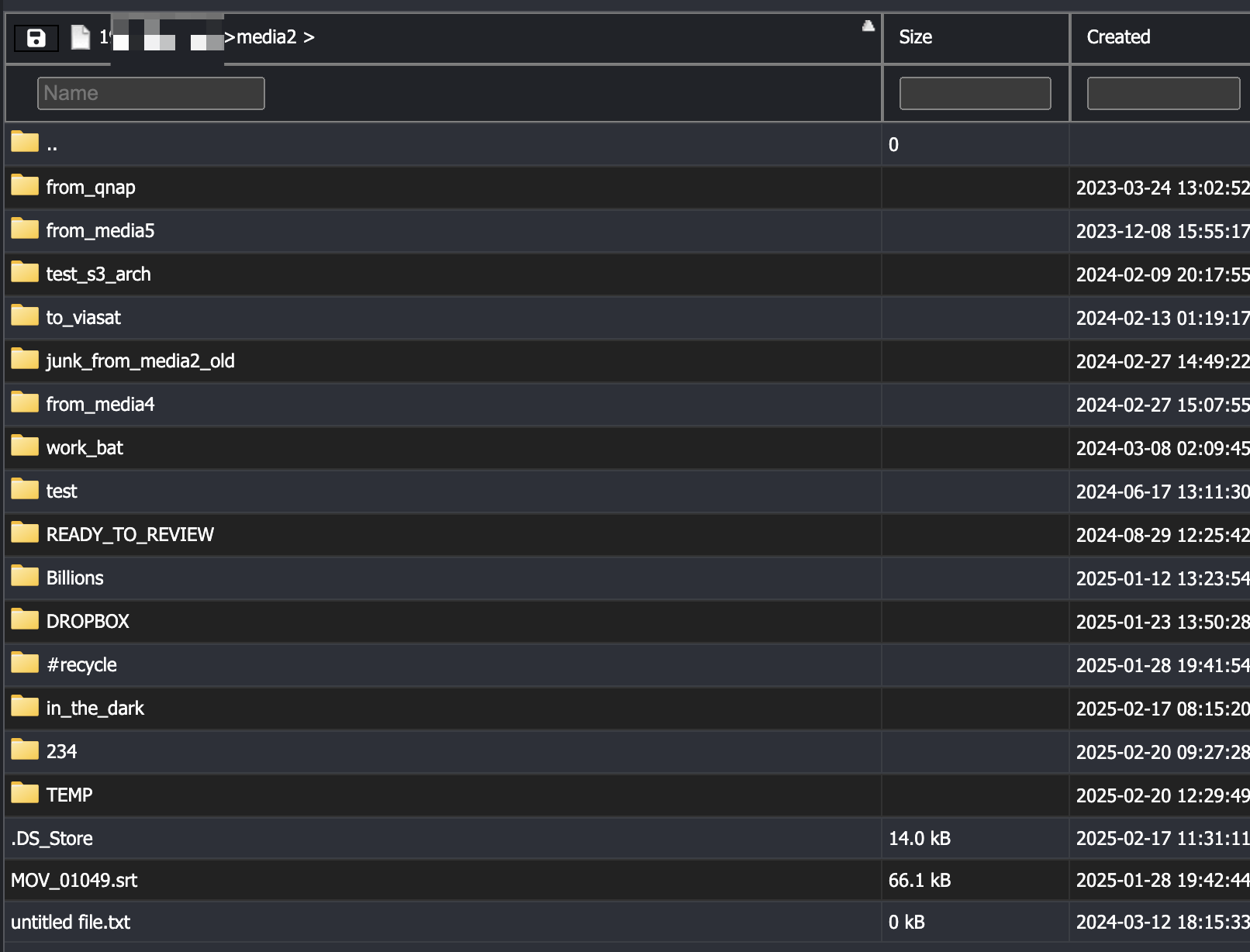

with dir command list is correct, but at webint is definitely not :)

krskvch wrote: Thu Feb 20, 2025 2:35 pm with dir command list is correct,
Can you send me the outptut of dir for the folder you did screenshot?
dir \\server\share\folder > c:\temp\dirlist.txt
