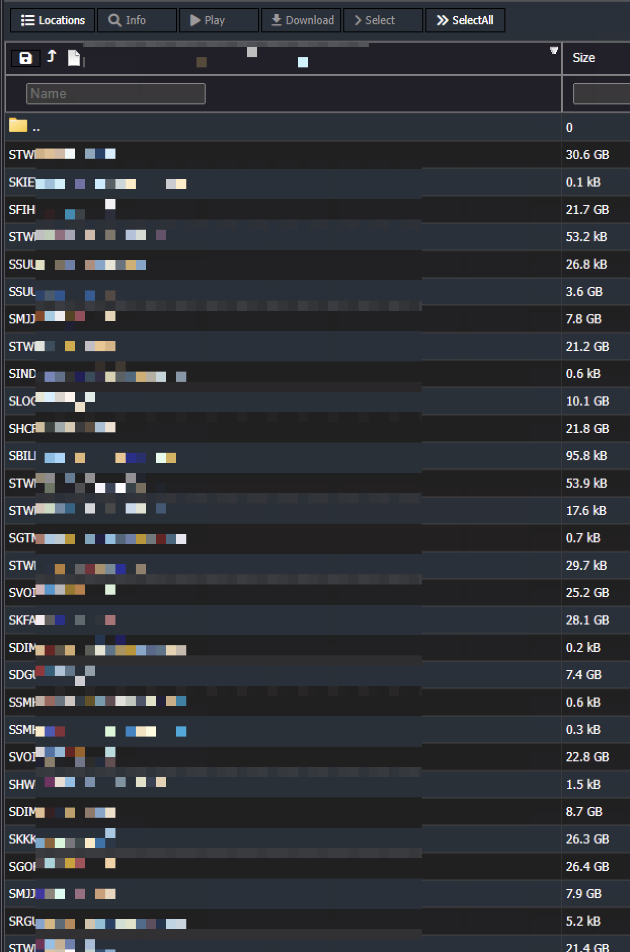

hi! i have an issue with file sorting by name when browsing at submit jobs page :(
May be you have some sort of hot fix?
@krskvch
Depends on whats your problem and what you mean by hotfix.
Wanna try the very latest? There was some work done in the file browser and sorting too.
https://github.com/emcodem/ffastrans_we ... .0.185.zip
krskvch
Posts: 10
Joined: Fri Aug 16, 2024 12:52 pm
Post by krskvch »
it's still have this issue :(

@krskvch
by default there is "no sorting, even if there is a little arrow. If you sort at least once, the sorting order should be saved and restored next time you visit the page, e.g. you only need to sort once by your preference.
Is it correclty sorted when you hit the column header to sort it once at least?
