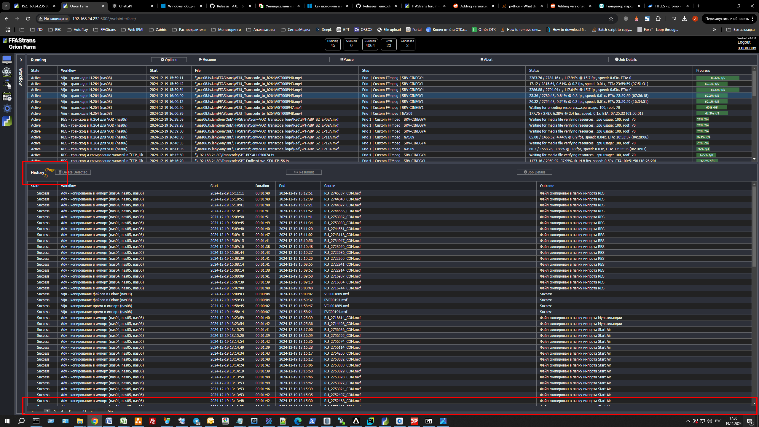

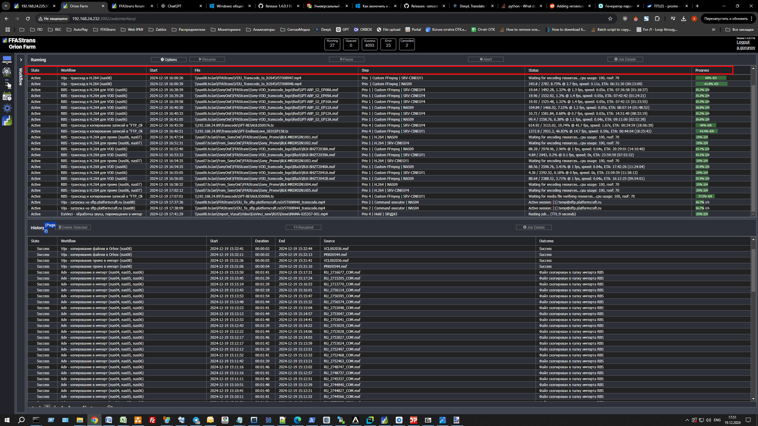

emcodem wrote: Mon Dec 16, 2024 12:41 am Time for a new beta
https://github.com/emcodem/ffastrans_we ... 0.116-beta
Thanks :D

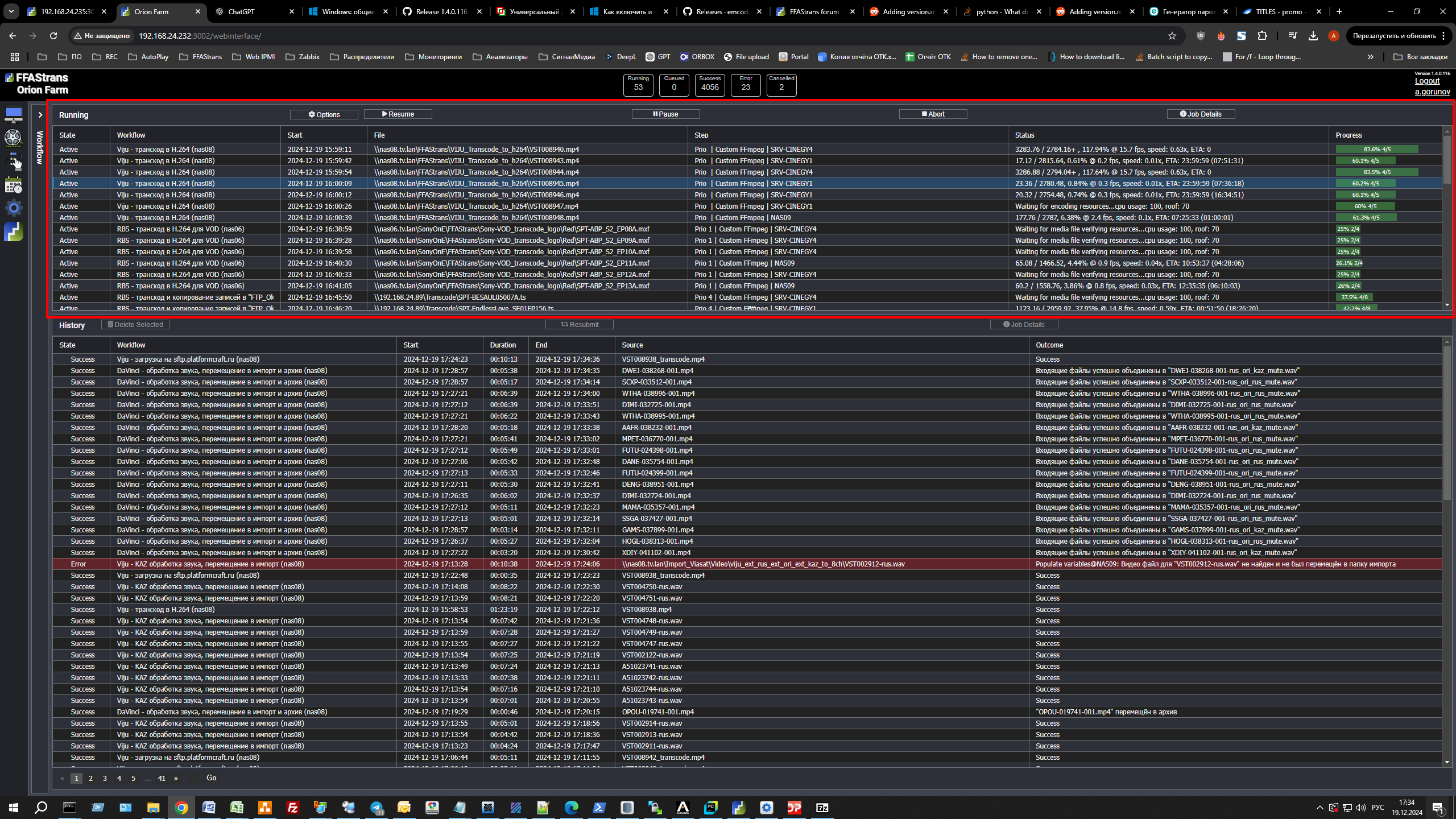

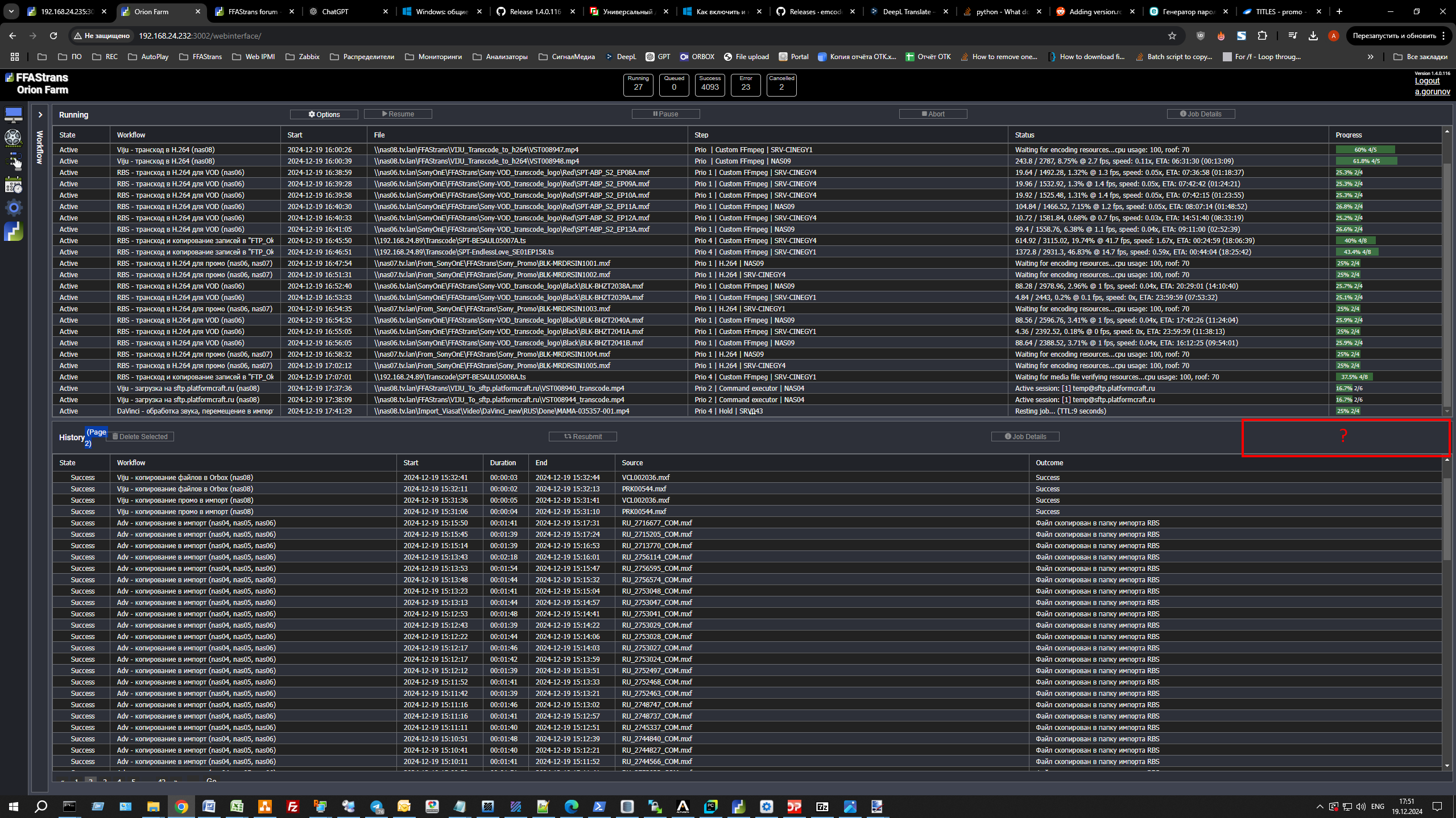

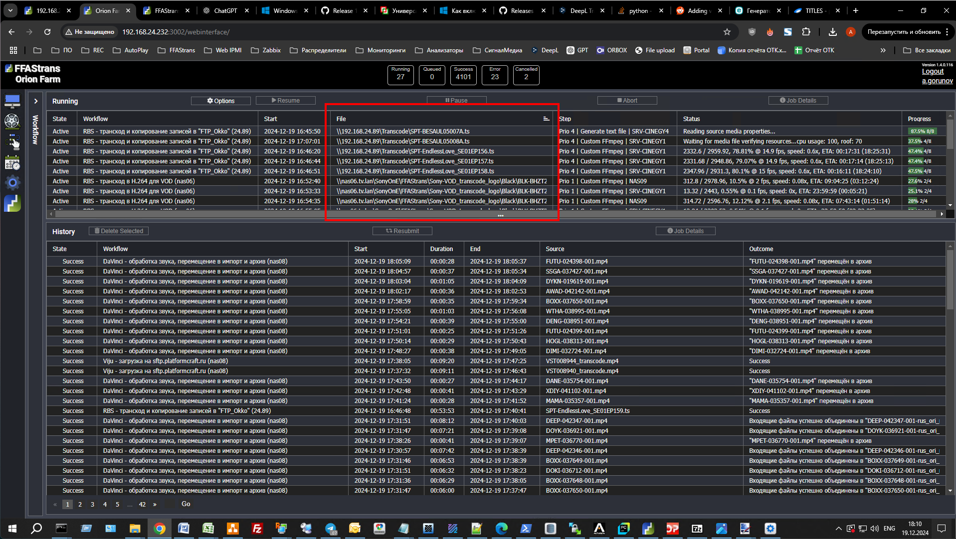

A small report on the issues noticed (likely most of it has to do with your currently ongoing rework, but still might be useful):
1) Looks like window of running jobs only updates upon manual page refresh in this build:
2) When switching to the second page and further in the history window, the page shifts down (apparently due to the “Page X” caption broken into two lines):
3) Layout resizer icon may be barely visible when the queue is full:
4) This area seems to have very narrow vertical frames, which causes the bottom of the letters in these headers to be cut off:
5) There is no longer a button to minimize the history window:
6) Is it possible to put the filename only back here instead of the full path (on 1080p monitors it can be a problem to fit all the columns needed)?
7) These windows are not aligned on the same line:
Posts: 1927
@DCCentR thanks, it is absolutely useful, i did not yet have all of the points on my list. Some of the points are already fixed, others not yet :D
Removing the path from filenames for running jobs was already done, then steinar complained that webint does not work exactly like the inbuilt status monitor so i reverted. I think it is more disturbing now because in the last version, we cut the right side of the path when the column was too small, i did not yet re-implement this feature at the reworked version. If thats not enough we might need to add a choice about how the stuff is represented.
I don't want to dictate how users wants to view their job status. Making it optional is obviously something worth considering. If not to add as option, one could also have an alternative column called "Job name".... which by default can be derrived from the file name and changed by the user by populating the %s_display_name% variable. This is awailable in the upcoming 1.4.1 release.

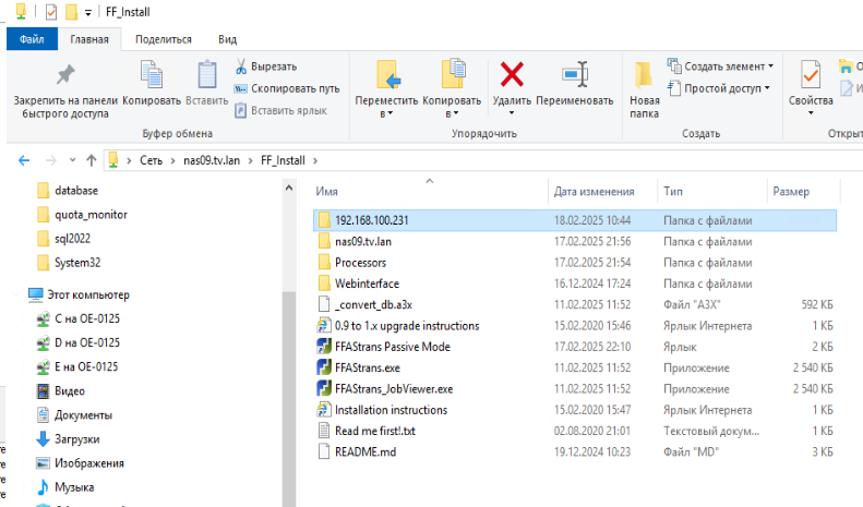

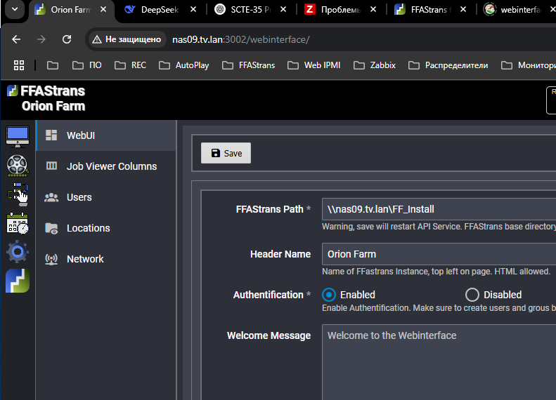

I'm trying to solve a small problem, server.exe keeps referring to a non-existent FFAstrans/WebUI installation path.
The FFAstrans/WebUI installation folder was moved from:
\\192.168.100.231\FF_Install\
\\192.168.100.231\FF_Install\Webinterface\
to:
\\nas09.tv.lan\FF_Install\
\\nas09.tv.lan\FF_Install\Webinterface\
Webinterface is currently running on nas09.tv.lan as service. Only one instance.
Снимок экрана 2025-02-18 110942.png (70.16 KiB) Viewed 200820 times

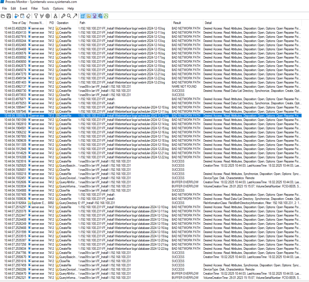

But for some reason Webinterface keeps creating the folder \\nas09.tv.lan\FF_Install\192.168.100.231 in the FF installation folder:
Снимок экрана 2025-02-18 110439.png (142.84 KiB) Viewed 200820 times
and tries to read logs from the path that is no longer valid - \\192.168.100.231\FF_Install\Webinterface\logs\
Снимок экрана 2025-02-18 111318.png (1.1 MiB) Viewed 200820 times
I was unable to find any mention of 192.168.100.231 in the settings/configs. What am I missing?
