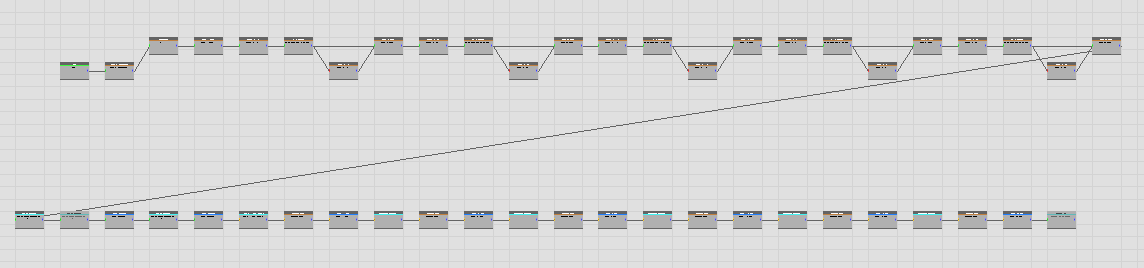

I know that you wanted to use the Web Interface to do that, but this could also technically be done via a watchfolder and I actually created something similar in the past, so I've just re-adapted one of our workflows for this.
Screenshot 2026-06-21 170618.png (15.65 KiB) Viewed 17608 times
Audio Interleave 6 Mono to 5.1 MMA_copy.json
(49.01 KiB) Downloaded 575 times
- Make sure the input files are PCM .wav with identical names and different ending nomenclature depicting the audio channel layout like so:
_L.wav / _R.wav / _C.wav / _LFE.wav / _LS.wav / _RS.wav
For instance:
UAT03426_L.wav / UAT03426_R.wav / UAT03426_C.wav / UAT03426_LFE.wav / UAT03426_LS.wav / UAT03426_RS.wav
- The watchfolder will couple together the channels to create the 5.1 (i.e a process called "interleave") and it will encode it in PCM 24bit 48000Hz 5.1.
- it will then deliver this file in the output folder with the name _51.wav
- it will then perform the Stereo downmix, encode it in PCM 24bit 48000Hz 2.0 and deliver it in the output folder with the name _20.wav
- it will then move all the input files from the Input folder to the Output folder and rename them with _MO.wav (i.e "Master Original")
A few notes:
The file that will be picked up by the watchfolder is *_L.wav and it will then check for the existence of *_R.wav and wait for 3600 seconds (i.e 1h) if the file isn't there. This should allow plenty of time for all the files to be copied and readily available in the input folder. :)
