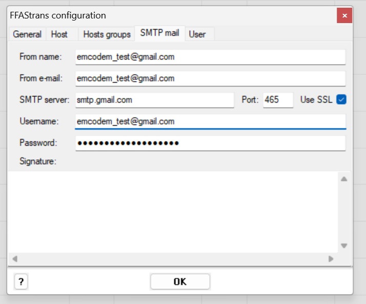

Further information, here are working settings at least for gmail:
Also, here a powershell script that replicates what ffastrans send email node does:
