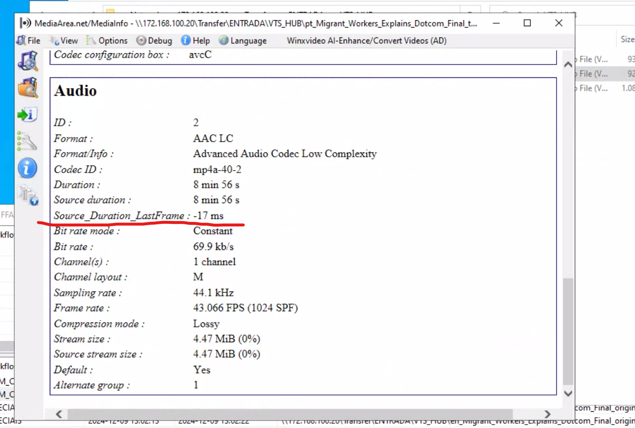

I've been facing some issues with this specific type of files. The users send a tv show to some platform that uses AI to do audio translation. The file that they send back always stops during conversion. I have tried a lot of things and they always stop.
Here is the one thing I found weird in Media Info, and here is the log
In this workflow I was applying the normalization, but even removing everything. The job stops at the same place.
Can you guys maybe give me a light ?

- Captura de tela 2024-12-09 141544.png (620.03 KiB) Viewed 18267 times

Well, thats a really short last frame
In your log, i don't see that it did actually encode or deliver anything, maybe i am blind tough.
As this is not reproduceable independently of source file, we'll need some file sample from you to investigate.
But even without such a sample i guess i can tell that the issue is caused by some speciality of the source file. As aac "frame duration" is fixed to 1024 samples, it is just natural that the last frame will alwas be special. So with aac, the audio is either longer or shorter than the video but it will most likely never match the video duration (independent of the input file).
However, it is the first time that i see a negative frame duration (does not mean much, i am specialized in production encoding not delivery).
As a workaround:
My guess is that it works for you if you encode to mxf first, no matter which codec, because mxf automatically forces exact same audio and video duration. I would try this first just to get it working once. Moving on i would play with different "pre rewrappings", maybe rewrap to mov but choose audio codec pcm_s24le.
